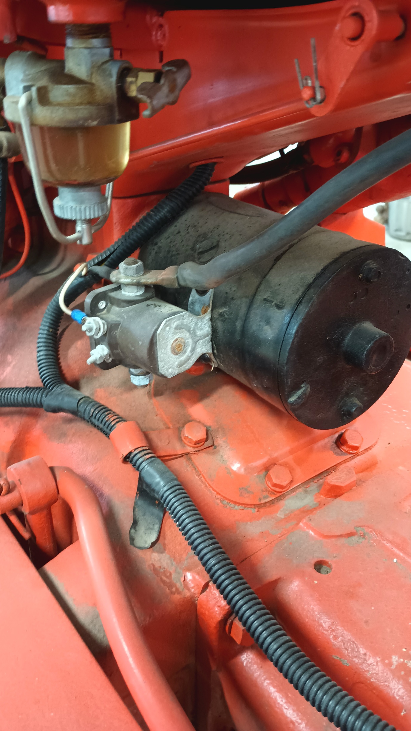

Leon B MO View Drop Down
Location: Old Monroe, Mo
Points: 2223
Post Options Post Options   Thanks (0) Thanks(0)   Quote Leon B MO Quote  Post ReplyReply Direct Link To This Post Posted: 26 Apr 2025 at 10:06pm
Here's what I did.  Starter solenoid mounted to stater. I had a spare D-17 key switch I used, kinda the same vintage. Very simple and clean. Turn the key to run mode, turn to start and key returns to run mode when released. But any parts store will have a simple start key switch.

mdm1 View Drop Down
Location: Onalaska, WI
Points: 2717
Post Options Post Options   Thanks (0) Thanks(0)   Quote mdm1 Quote  Post ReplyReply Direct Link To This Post Posted: 27 Apr 2025 at 6:00am
I like how you have mounted the solenoid. I will pick up my starter this week.

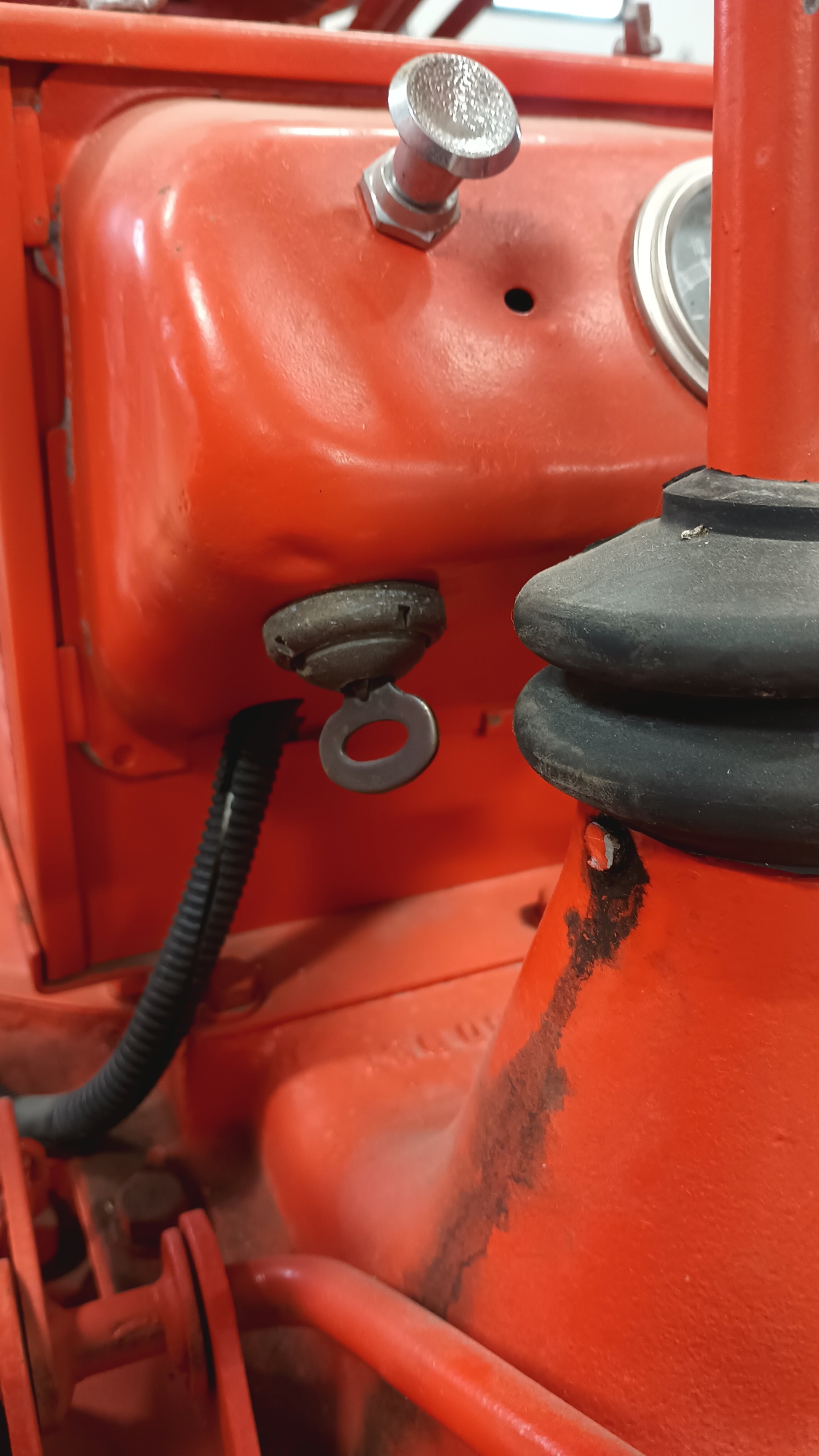

mdm1 View Drop Down
Points: 2717
Post Options Post Options   Thanks (0) Thanks(0)   Quote mdm1 Quote  Post ReplyReply Direct Link To This Post Posted: 07 May 2025 at 6:18pm
I got my starter back from the shop. I mounted the solenoid on the battery box and the push button I mounted using one of the bolts from the quadrant. Nice and convenient. Got it all wired and no starter. End was my battery was no good. It may have started with the old switch and a new battery but I'm happy I went this way. My key is on-off so I wired the push button through that so the key has to be on to turn it over.  Tractor never started so good. Thank's for the help and suggestions.
