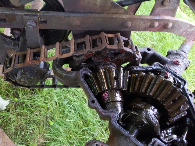

WTB a spare of these chains? (IH)

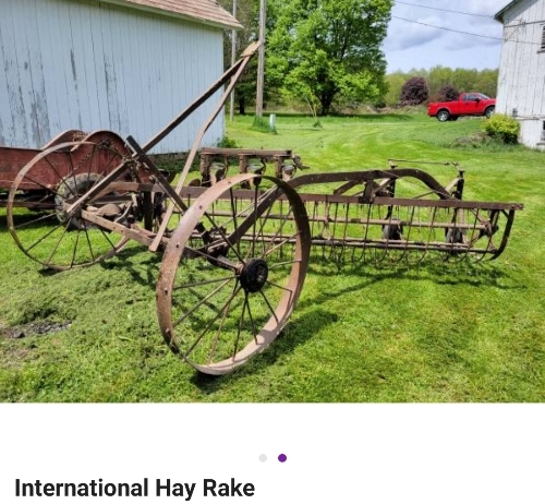

Wish I knew the model also?( Guy bought it off of said it was a international harvester brand but I can't seem to find out what model it is)
I'd also like to know what gear to rake in with a Allis Chalmers B 1950?

You should be able to find that sort of chain all over town. It will probably require shortening it to that length but thats universal 'steel detachable chain'. Trophy old rake, I bet it will handle 3rd gear.

It's a typical chain. JD, Case Ih have it in rolls. Most will sell you the number of links you need. It's probably a #55 chain. Just to be sure. Take it with you. Looks like a 4 bar rake. That would make it a later steel wheeled rake. It may never had a model #. 3rd gear might be a little fast for that rake, you will just have to try it and see how clean you can get your ground. But you should have no problem pulling it in 3rd.
