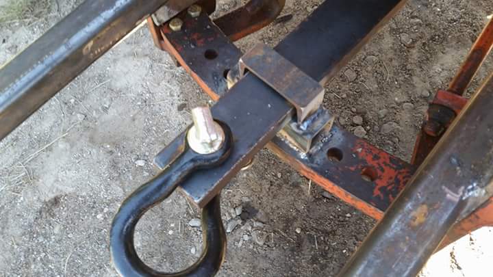

FB_IMG_1444024984366.jpghere is a picture of my draw bar I'm running on it 20 inches hight about 3 inch out from the draw bar support

JW...that looks like mild steel, don't it bend down while pulling?

Shameless its 1 inch thick I haven't bent it yet and its a little wider than the factory draw bar, its actually wear resistant steel bar we use at work a little bit better than middle steel.

o-k....it's just that I've seen the heavy drawbars on the 7000 series bend at pulls. was just wondering...

I don't think I can bend it but I could be wrong on that I have seen stuff you wouldn't think you could break broke in dozen parts too or bent up.

That drawbar is already a lot longer than what I run. I would also lose the clevis and make something that fastens solidly to your drawbar!
Tires are also very important, and as said earlier 38's are pretty much a must have.

It's almost impossible to tell if a drawbar is going to work by looking at it. A drawbar that doesn't work at all might work great if you can relocate 500 lbs. from the front to the extreme rear of the tractor.
On the (antique) WD-45 I occasionally pull, I can't come close to getting the front end light at our local county fair which has a stone dust track with very little bite. When we pull on a clay track about 40 miles away, without changing one thing, I can't keep the front end on the ground.
There are a few things you might be able to do to help your spinning out situation:
1. GET RID OF THE CLEVIS !!! If your association allows it, make a 3/4" to 7/8" steel plate with a 3" round hole that bolts to your drawbar. Your clevis drops as soon as you tighten the chain. You might lose as much as a couple inches of drawbar height with a clevis.
2. Lighten the front end of the tractor (which is usually not as easy as it sounds).
3. Put all the moveable weight behind the rear axle.
4. You might want to have someone video your pull and watch the rear tires. I always felt the secret was hard tires on a hard (clay) track and softer tires on softer (stone dust) tracks.
5. Try making your drawbar adjustable in and out and up and down. When you vary tire pressure, you need to compensate on hitch height. I use two overlapping steel bars with several 5/8" hole in each, so I can adjust in and out easily by removing a couple bolts and adjusting the overall length of the drawbar.

I agree lose the clevis before you hook again, I would be way more concerned with that p.o.s. cast pin than bending your draw bar. now is this a pulling only tractor or a farm tractor, if it is a pulling tractor shorten the draw bar up to 21 inches from center of the rear to the hook point ( i go 21 so no pissed off tech can say your 1/16 of an inch to short and you cant pull Wink ) now set it to 20 inches high if that's what your rules say and start taking weight out of the front end and add to the rear until it hooks up.  think about it this way have you ever seen  a super stock  or a modified  with a long drawbar , NOT  as I asked before next time you go across a scale what's the front to rear weight I would not be surprised if your not close to 50 50  it takes work you need to get some where in the 70 -80 %rear mine 70% at 5500 weight brackets need to be as far back as possible and yes  every inch matters
