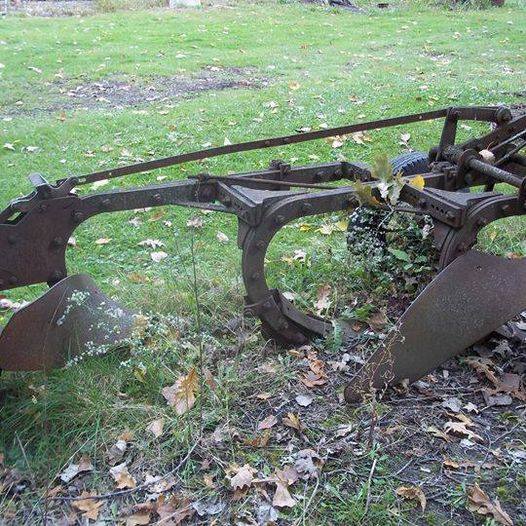

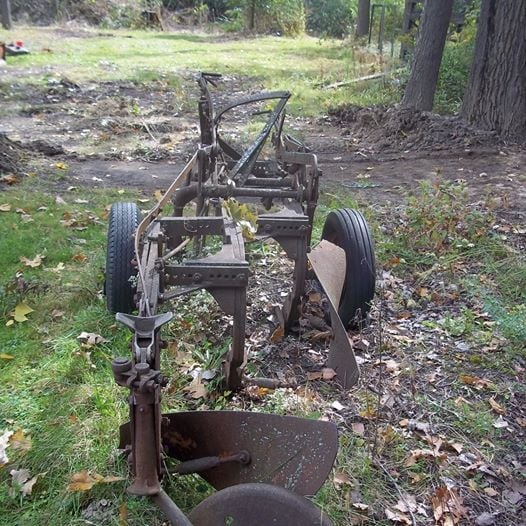

So, I'm looking at buying this guy:
I know I can rig a means of pulling it, and looks like it has a mechanical arm to raise and lower the plows while the trailer stays on ground. It's an old IHC.
My main question is, do I have enough HP to drag this through the soil at 9" or 12"?

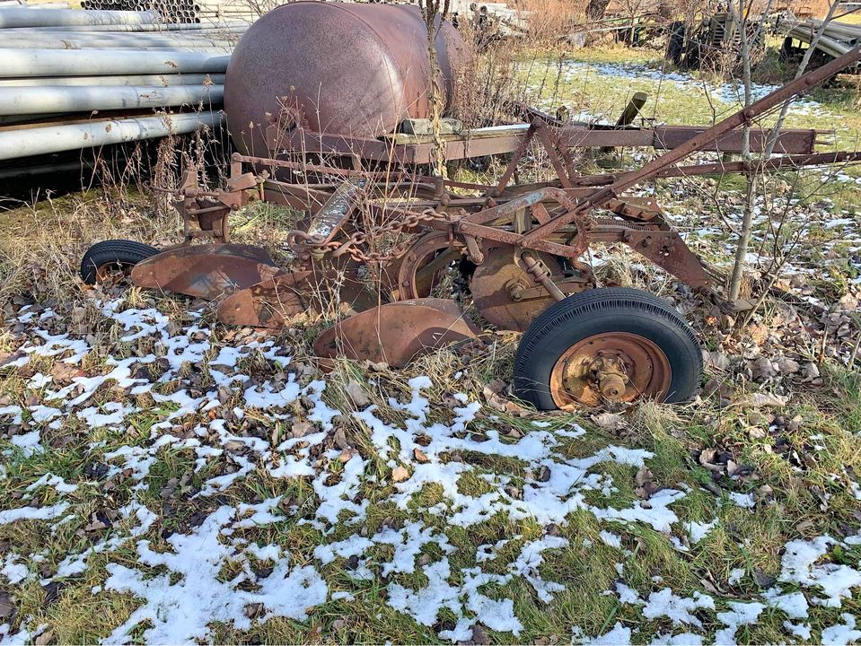

So, picking this up for $75 tomorrow
Started out life as a 3, but as you can see it only has 2. And the $75 price makes it a no-brainer to swap the plow over a location, and restore the whole thing for operation.
One rim is totally shot, plan on getting a matching rim and cutting out the center meat and reweld the steel spokes back to the rim, then some decent used tires on both sides. There's obviously a few bent parts and pieces that will require straightening and amendment, not to mention cleaning, greasing and oiling everything else.
To address the debris issue, we keep all the field stone and collect the other debris and take it to a city dump for $20 a ton per trip.
