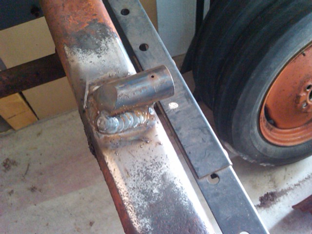

I've never seen a CA wide front that wasn't wore plum out. Most so bad they are actually riding on the cast bolster. Here is a fix in progress with grease hole. Pin size was made larger to 1".

that looks good , you are right though most of em are in tough shape

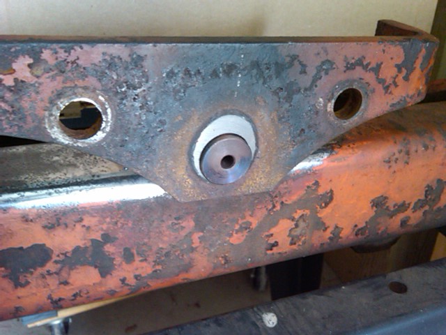

Hey Bill, nice job! I like the grease fitting idea. I'm also in the process of rebuilding one of my wide fronts. Welded and ground the pin, double passed all the old welds, and added a couple support brackets to the wishbone. Post more pics as you get further along in your rebuild. Ron

Here are some pics of mine.
