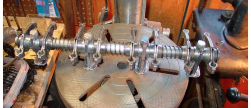

here is a photo of the rocker arm shaft with the rockers installed... are you saying the rocker arm BORE is worn and it wobbles on the shaft ?   I have never had that problem....(maybe they wobble a few thousandths and i have never considered that a problem ???)....  I have never checked the spring tension either.. only problem i have noticed is the rocker arm pad that sets on the valve is not always centered on the valve.. Have seen serveral that are way of center... but dont seem to hurt anything..

Both the rocker and the shaft have deep wear grooves...when it twists, the contact point can slide and cant 1/8 inch. Only one has this weird behavior...
