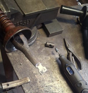

10/26/2025 Status (7): The Dunham Lehr disc rims were not in good shape.  One of them was completely mangled.  Can't even imagine how it could get twisted that way (or the tongue crank handle).  The other one could possibly be salvaged with a week's worth of work.  I opted to order some new rims and had Pomp's put some trailer tires on them.  This increased the disc value by 500% or more Big smile  The better one had a G78-15 tire on it which would have been sometime in the 1970s.
Edited by dfwallis - 26 Oct 2025 at 3:32pm

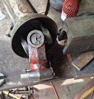

10/26/2025 Status (8): The last item was to remove and start cleaning up the disc hydraulic cylinder.  If anyone knows what brand this would be, please let me know.  AI says they owned a company called "versahaul" which made the cylinders, but I didn't find any parts for those.  The closest appearing end cap/gland/head I saw was for a bradco.  There is some minor pitting in the barrel and on the rod, but the rubber O rings all look like new.  There was only a very tiny amount of water that came out of the petcock.  I ordered a new 10' hydraulic hose for it.  The old one was 9'4" and consisted of two jointed sections, one 1/2" and one closest to the tractor 3/8" but with 1/2" NPT fittings.  I'll probably buy a breather plug for it after I decide what I need.  Hopefully the hydraulic shop will be able to identify it (but I have my doubts).  In any case, they said they could likely get it going.  The gland is broken at the very end where the retaining rings hold it in place.  The inner retaining ring will be fine, but the outer one wouldn't really fit against anything.  It isn't really clear that the inner ring isn't sufficient, though.  I ran out of time to inspect this further.  The gland is aluminum.  It looks like it would be easy for a machine shop to duplicate or perhaps create a separate clip piece that can be attached.
Edited by dfwallis - 26 Oct 2025 at 4:09pm

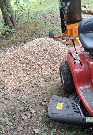

It was leaf mulching time, but all of the mowers were broken.  It was about to rain, so I tried to get one of the riders going.  I replaced the two deck spindles (which were probably used on another one), sharpened the blades, cleaned, and painted.  I also straightened the deck wheel brackets.  I moved to the engine itself, replaced the battery and got it started, but the float was sticking and dumping a huge amount of gas into the cylinder.  I cleaned the carburetor but all of the rubber gaskets were deteriorated.  So I ordered a new carburetor for about the same price as a gasket set.  It didn't arrive until the last day of the trip when I was trying to get things cleaned up to leave.
Since it was clear I wasn't going to get the rider fixed, I went to town and bought the lowest end push mower they had and mulched the main areas.  It was very wet and things didn't mulch well.

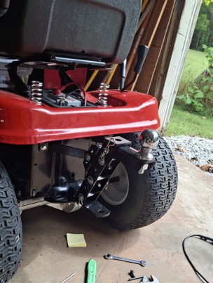

I spent several days getting one of the 4 broken riding mowers going.  It seems to be working fairly well but the governor is not working correctly.  It keeps trying to rev to max RPMs.  I had to add an extra spring to bring it back to idle but the one I chose isn't quite strong enough.  But I am able to control it over a very short range.  Needless to say it doesn't "govern" properly, but at 16HP, it doesn't bog down that much anyway.  I ordered a mulching kit for it.  I installed the new carburetor and I had to straighten the front steering linkage crossbar, the deck, and the deck belt engage return spring bracket/rod.  I tried adjusting the governor but there's very little adjustment to be made.  Adjusting it to the "correct" setting per the manual leaves it revving.  I could perhaps force it to limit the revving travel, but then it wouldn't have enough travel to perform the governing function (adjusting under load).  More investigation when it warms up.  It was annoyingly cold most days.
The other activities included fixing the left side garage door spring so my sister could raise the door (left cable frayed), and began work on the barn roof.  It's starting to leak, several rust spots, and the drip edge is frayed from rust.  As a deterioration delaying tactic, I started pop riveting a flashing strip over a spray on rubber coating.  This is partly to protect the rubber coating and to provide the to-be-applied top rubber coating something to stick to underneath.  That will probably consume the next trip as well.  I ordered a new 12 foot ladder so I can climb on the roof.

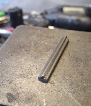

I wanted to make sure I have something ready for my next trip, so I made a draft (clip) spacer for the pickup plow pull bar.  I'd still like to acquire the correct one, but this should work if I can't.
This is probably too thick to set the tongue at the right angle so I'll probably have to shave the bottom slightly.  I don't think that's really critical though since you're never going to have a plow and tractor on perfectly level ground in the real world.  If it works as-is, I'll probably not modify it.  If I have to modify it, I'll consider cutting the sides at the same time to match the snap coupler rendering rather than the pin hitch rendering in the plow manual.  What is the purpose of the side cutouts?  Perhaps better moisture drainage?  Better greasing access?  Change for change sake?

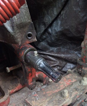

The main project was to finish up the PTO adapter.  I worked this up mostly at home in TX then shipped the developmental version (which of course doubled the cost).  I tried it out with the finish mower and it worked better than I anticipated (I expected broken chains and nuclear explosions or worse :( :)  The only issue really was some of the set screws came loose (and the chain stretched).  I thought sure I did a final check of them all.  All of the loose ones were on the lower shaft.  All of the upper shaft items were fine.  I do have a vague memory of adjusting the lower shaft to gain clearance to get a wrench in behind, so maybe I just forgot to tighten everything back up :(  I also bought some additional locking collars if this proves to be a problem (that locktite won't fix).
My original goal was to make this adjustable from 16 inches above ground to 20 inches above ground.  However, my memory of the height of the drawbar was off by 1/2 inch so it ended up that about 17 inches above ground is as low as I could go (without modifications to remove the drawbar obstacle).  The lower sprocket (4 inches) would likely be too close to the drawbar.   So, it is set at 18 inches which was my normal operation goal and seems to work well there.  I had made 3 sets of chains for 16, 18, and 20 inches.  The actual adjustment range of the backing plate is 16.5 inches to 24.5 inches, but fitting in the sprockets and idler (and eventually an oiler system) limits the practical range of adjustment.
It has a quick disconnect PTO overrun clutch at the top.  All of the original ones with the quick disconnect had much too short PTO shafts.  They were only a little over 2.5 inches long.  That's not long enough to extend through the backing plate, the bearing, and have enough left to mount the sprocket onto.  So I had to purchase a separate PTO extender adapter that had an extra long PTO shaft to create an overrun clutch with the correct characteristics.  I cut the original PTO clutch shaft at 5/8 inches, cut the PTO extender  back end socket to 5/8 inches and then welded the new PTO shaft on.  It appears to be running very true (a worry).
It has a chain tensioning system that consists of two fine threaded rods that pull down on the lower bearing flanges.  These firmly prevent slippage.  It might have been enough to tighten just the bearing flange bolts and eyeball the chain tension, but I prefer having this fine control over the tension adjustment.  I think that the chain stretched more than anticipated on first use though.  That's concerning, but will see if that continues after I re-adjust.  I may need to remove a chain link to keep it at 18 inches above ground level.
Mounting stability at the bottom is through 2 threaded rods mounted to the drawbar bail.
Bottom end rotation prevention is mostly provided by a cutout in the bottom of the backing plate that allows it to slide below the top of the drawbar.
Since this device is very heavy, in order to try to lessen the weight load on the tractor PTO shaft, I created a downward facing set screw that presses on the top of the drawbar and raises the device just enough to reduce the weight on the PTO shaft.  This is likely going to have to be adjusted periodically (has a locking nut but things will wear).

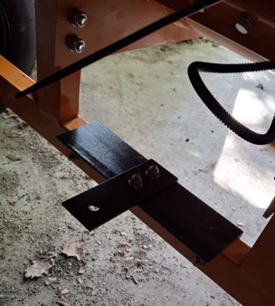

I made some adapters to position the KK dirt scoop further back to keep the scoop from hitting the drawbar, but my original solution had the lift points too low (scoop could not quite be lowered enough at the right angle) so I scrapped that design and began a new one to get the lift arms back up in line with the originals.  Since both the front and the back end need "anti-rotation" protection (because the add-on top link slides on the rock shaft and doesn't support pushing), I'll do something similar on both the front and the back.  The starting point is two long rails on either side that I can bolt the new brackets to when the material arrives.  The back doesn't need to be very long so I'll size that as needed once the brackets are designed.
I previously created some substitute "bail pinning" bars that work similar to pinning the hydraulic arms to the pin hitch bail.  I added two new "scissoring" bars that allow me to adjust how high the implement is lifted.  It basically adjusts where the "end of throw" is.  They may be slightly undersized but I don't generally leave the lever in the raise position, I get it to the right height then place it in the hold position.  This will just make it easier to stop it at the right place (mainly for PTO implements where you don't want an extreme PTO shaft angle).  I'm pretty sure they'll be fine when the high implement weight is already reducing the lifting force that will be applied to these bars.

Unfortunately, the overrun clutch stopped overrunning.  Either the welder got it too hot, or the side stress caused by the chain is too great.  I'll have to investigate that next trip.  :(

2) For mounting my PTO chain drive adapter, I needed a guide to help me mount it true, to minimize side force (and weight) on the CA PTO shaft and the overrunning clutch attachment.  The below guide slides into the stock PTO guard and has extendable rulers to help me get the alignment right.  I clamp it in place to the PTO guard side braces.  The cutouts are to avoid bolt heads and welds.
In another post, I had mentioned difficulty with the overrunning clutch not releasing with even light hand pressure.  With this guide I was able to accurately adjust the attachment to allow the clutch to operate correctly.  The vertical weight adjustment of the attachment is also required of course.  I may have to beef that weight adjustment up some.  It is a single 1/2" bolt that presses down on the top of the drawbar.  But after mowing 3 acres it seemed to still be properly adjusted (the OR clutch was still releasing).  The attachment is slowly becoming more reliable as I work through the issues.  I'm pretty sure I'll have to continue to check alignment before every use though.

2) I modified the MF41 PTO connection from spline to quick disconnect.  I had to make a custom key to mesh with the 19-spline shaft.  Technically, it wasn't necessary because I also drilled a matching through hole for a 5/16 bolt.
3) I installed the new lock in the OEM PTO shaft.  It will be unused since I couldn't shorten it without damaging the shield slide mechanism.  I purchased a new PTO shaft to connect to the CA.  It looks like it fits perfectly as-is (no cutting).  How often does that happen???

5) I bought a new mower AND 6" chipper and put it to use starting to clear some of the fallen trees and raising tree canopies.  My brother removed the 4 dead mowers but hasn't yet found someone that wants them (I rebuilt one that died again but decided it was going to take forever, so punted).
Tree (7 tulip poplar) canopies raised for easier mowing.  I also removed a bunch of brush and two cedar trees.
6) Installed new hitches so I can pull the chipper around easier.
The truck is severely rusted.  The bumper is almost gone, just a shell of chrome.  So I added a new "class 4" hitch.  If I actually pulled 10,000lbs, the truck would probably split in the middle though :(
Custom hitch for the chipper to pull the garden wagon behind with various tools.  I didn't start on the garden wagon repair.  I was waiting for the pest control company to eliminate the hornets swarming around it.
