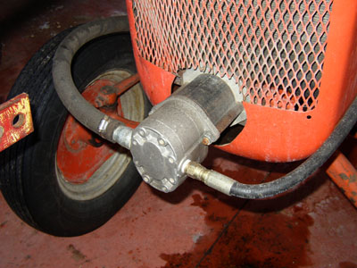

Post Options Post Options   Thanks (0) Thanks(0)   Quote SteveC(NS) Quote  Post ReplyReply Direct Link To This Post Posted: 18 Jun 2012 at 2:05pm
Orangeman, here's a pic (I hope) of my installation on my B.
I mounted the aluminum on the rad support and the shaft extension goes into the black pipe spacer where the Lovejoy coupling connects the crankshaft extension to the pump .
The lovejoy takes care of minor missalignment and has worked for going on 10+ yrs. now.
I'm looking at an installation for my CA. the 2 bosses that protrude through the rad. cowl look like great mounting points for the pump and it's adapter.
You need a metal lathe or a friend who has one for the mods to the pulley for the extension shaft.
I have also seen some neat belt driven extensions installations that require less machining.
PM me if you want more info

Hey Guys: Wonderful information you have shared.  Really appreciate all the input.  I can see now why Allis came up with the I 40 and I400, with the deeper/heavier grill section with the pump on the front makes for a real nice setup for the hydraulics.
I have a Dynahoe backhoe that utilizes a very similar setup, a big Vickers pump on the front mounted to the main frame which is coupled to the front crankshaft of a Continental F-244 block.
Steve - extra nice job on the pump fab.  I have four CA tractors and can see where the tapped mounting bosses for the cultivator brackets just below the radiator cowl would be really handy to mounted the pump plate on.
