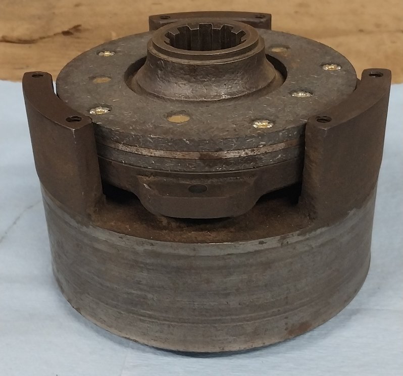

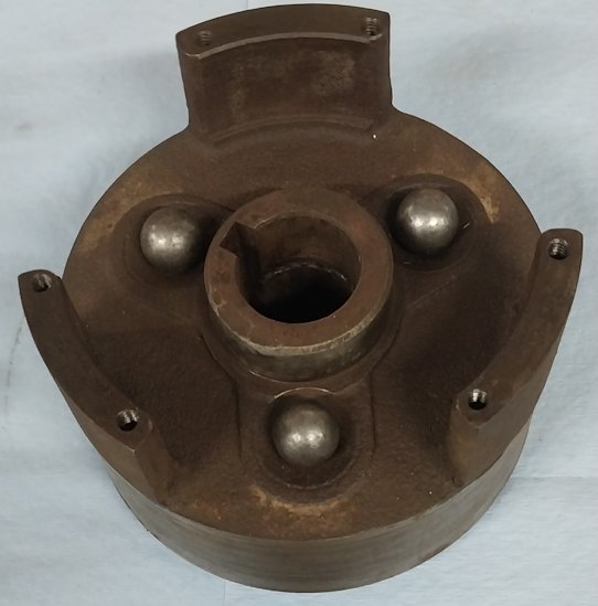

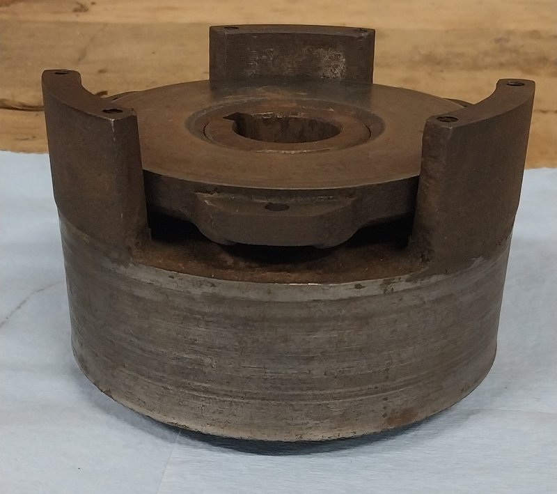

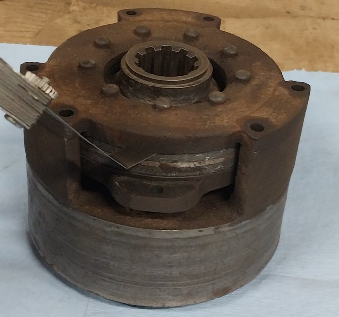

Originally posted by Dave(inMA) Dave(inMA) wrote:
I assembled the clutch pack today. New springs, new disc balls. Put the pack in my shop press and applied pressure. Here are the pictures of the compressed pack - the white arrow indicates where the gap opened up in the pack. The second picture shows the compressed pack with 0.072" of feeler gauge inserted. So my gap is 0.052" over the recommended width.
I am dredging this thread up because I am in the process of rebuilding my CA hand clutch. I am seriously questioning the need to have the clutch fully assembled in order to check the clearance.
Clutch balls in seats (I have not yet installed the center bushing).
Primary pressure plate sitting on disc balls; this is as far as the plate will go even when the fully assembled clutch is compressed.
Clutch disc sitting on primary pressure plate
Secondary pressure plate sitting on brake drum ears with 0.015" feeler gauge in gap.
I did this same test with the unit fully assembled and compressed with large C-clamps; I measured the same 0.015" clearance in that test also.
When fully assembled, the springs force the primary pressure plate toward the secondary pressure plate, thus pulling the primary pressure plate away from the disc balls.
It is easy to see that this clearance will increase when the pressure plates are re-surfaced, but it would require massive amounts of material removal to end up with the 1/4" clearance mentioned in previous posts, although it is certainly possible.
