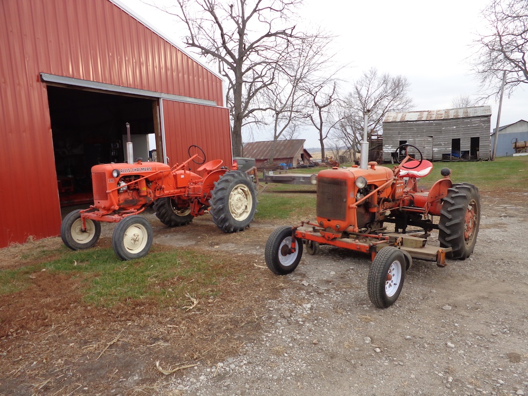

I just ordered a pair of Carlisle implement tires for my CA. It is used for mowing my yard and with   three rib front tires it would cut into the lawn when turning sharp. I am hoping with the implement tires to avoid this. Does anyone else have implement tires on their CA and what do they think of them? Thanks, Tim

Not implement tires but I have 'trailer' tires on the front of my CA-1. Did that for the exact same reason as you. Yes, it helped a ton! The tri-ribs cut up the yard pretty good, car tread does not, (as bad).
