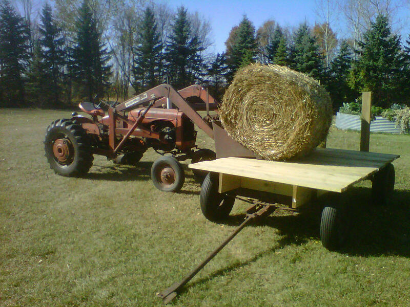

I have a CA with a loader I never use it I find the WD45 is a much better loader tractor. It is just about as manauverable a lot easier to steer and much better with a three point. The CA will lift way more than it should. Has plenty of power but is hard to steer even with an empty bucket. The Pto is to high for normal 3pt equipment. And the hand clutch is kinda fragile. You can buy two Wds for what a single CA will cost you. WD trip bucket loaders are very durable, cheep and easy to find. My CA has a model 108 loader a very strong loader but hard to find and costly. I had no problem putting that 5X6 Straw bale on the wagon. its about 800 lbs.Power steering was never avaliable for a CA and would be very hard to self engineer.

With everything working as it should, any decent CA would laugh at 800#.
Father used to dig out stones large enough that he had to stand on the drawbar to have enough weight on back so as to drive/push/roll the rock to a hedgerow a couple hundred feet away. Had loaded 24" rears and no rear cast weights and he only did this in tilled ground as he did not want to wipe out the front end.
