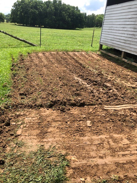

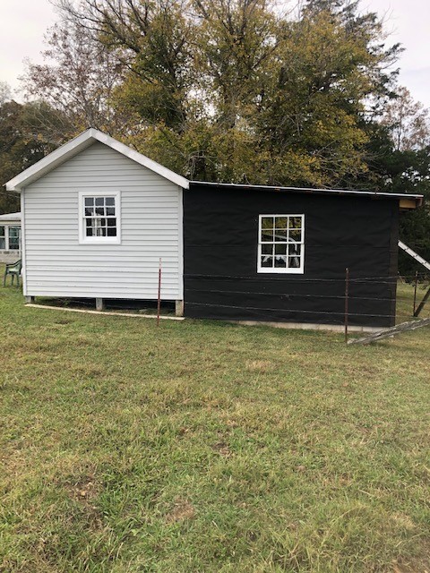

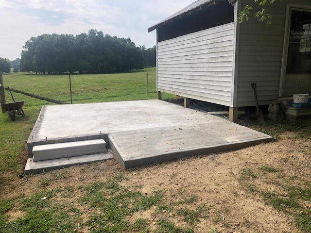

I been working on a good dry place to store the D-10 and my motorcycle. I been working on it off and on since July, but I actually started it last year. Winter set in and it stayed to wet to dig until summer. Now winter is setting in again and I'm still working on it.
got top soil scraped off ready to dig footer.

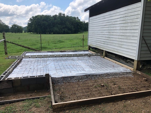

Blocks laid, gravel, all formed up ready for concrete.

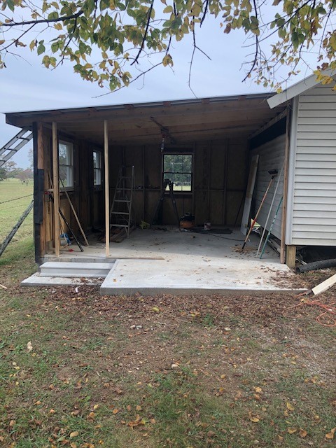

Pad done.

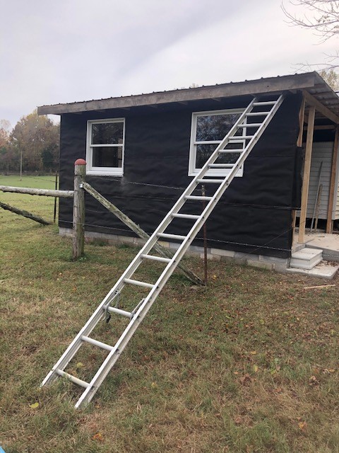

This is how it looks now. Still a lot of work to do. I'm using a lot of sawmill lumber my Dad had cut and stored years ago. It's hard to work with and makes it go slower. I think my Dad would be glad it's finally being used and didn't go to waste. I plan to put vinyl siding on it to match the building it's attached to, can't have an eye sore in the backyard. I hope this will be a good building. My biggest concern is the roof is really flat. Only drops a foot in 14 feet. I didn't have much choice, but no leaks so far and hope it stays that way.

Post Options Post Options   Thanks (0) Thanks(0)   Quote steve(ill) Quote  Post ReplyReply Direct Link To This Post Posted: 11 Nov 2019 at 10:13pm
I have a car port with about that same pitch on the roof... Steel roof like yours... seems to work fine.

Post Options Post Options   Thanks (0) Thanks(0)   Quote DMiller Quote  Post ReplyReply Direct Link To This Post Posted: 12 Nov 2019 at 4:40am
Did you add a vapor barrier Under that roof? if not will likely rain inside every so often from condensation. Looks like a fine shed.

Post Options Post Options   Thanks (0) Thanks(0)   Quote Ranse Quote  Post ReplyReply Direct Link To This Post Posted: 12 Nov 2019 at 8:36am

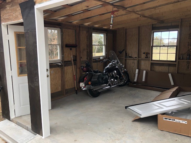

The answer is no, and I've noticed a few drips in the floor already. You can write your name on the bottom side of that tin every morning. I've never noticed that on the old building the shed is attached to. I think this roof is worse because it's so flat. I was going to use that 1/4" Styrofoam insulation between the metal and lad. I thought I allowed enough room for it, but after the rafters and lad went up I decided it would be to tight getting the new metal under the old. I'm going to put 3 1/2" roll insulation between the rafters. I already have a bundle I bought for a different building.
Condensation is a real problem in the all metal building were I keep the D10 and B now. Sometimes both tractors will be covered in water droplets sitting inside. Sometimes I think they might be better off outside. My motorcycle sits in an open metal carport, and it has suffered some rust because of it. This shed has a concrete floor, 3/4" OSB walls, and the thick black tar paper is a great moisture barrier. I'm hoping with the addition of the insulation and vinyl siding, this will be a moisture free building. A good place for my toys, unfortunately, I don't believe there will be enough room for the B as well.

Post Options Post Options   Thanks (0) Thanks(0)   Quote jaybmiller Quote  Post ReplyReply Direct Link To This Post Posted: 12 Nov 2019 at 9:40am
My concern is 'snow load'. 2by8s(?) spanning 12'(?) is really 'marginal'. OK for rain, but snow can buildup and collapse roofs. See that happen here ,all the time....sigh.

Post Options Post Options   Thanks (0) Thanks(0)   Quote Ranse Quote  Post ReplyReply Direct Link To This Post Posted: 12 Nov 2019 at 9:56am
I thought about that as well, but I live in Tennessee. We seldom get more than an inch of snow, and six inches is a blizzard for us. That only happens every 10 or 15 years.

Post Options Post Options   Thanks (0) Thanks(0)   Quote DaveKamp Quote  Post ReplyReply Direct Link To This Post Posted: 17 Nov 2019 at 12:34pm
Yeah, you won't have much snow-load to worry about, as long as you don't get an ice storm, it'll be okay.
The only other way to defeat the roof pitch issue, would be to move the upper edge from below the prior roofline, to halfway up the peak, and then build a gable on the far end.
Condensation from underneath happens because the roof is cold, and the air inside is warm and moist.  You can add insulation, but the real fact, is that there's moisture in the concrete that'll be coming up for a long time, and being an unheated space, you'll always have something cooler than the air to condense against.  Adding heat, and exchanging with dry air is the only thing you can do.
Having a small air volume underneath the roof means that on a sunny day, it'll be really hot in there... ventilation will help mitigate lots of problems.

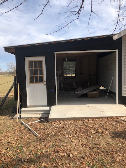

Post Options Post Options   Thanks (0) Thanks(0)   Quote Ranse Quote  Post ReplyReply Direct Link To This Post Posted: 17 Nov 2019 at 8:32pm
Once the garage door is up (which I dread starting) the building will be pretty much dried in. I'm not sure if I'm going to start the vinyl siding right away or not. I don't have access to a Sheetmetal brake anymore, so I'm not sure how I'm going to get it done. I've been painting all the exposed wood for now.
I'm still getting some condensation in the mornings. I haven't put up any insulation yet. I thought instead of using the 3 1/2" roll insulation, I would get the 1/4" Styrofoam insulation and cutting it in 23" strips. I could staple them to the lap between the rafters. This would leave a 1" airspace between the metal and Styrofoam. I thought this might work better than having the fluffed up insulation right against the metal, but I'm not sure. I may get condensation no matter what. The old building has the same type of metal roof and it doesn't get any condensation, but it has a wood floor and is off the ground. I did put plastic under the concrete. On top of the gravel, not the dirt. I'm not sure which is best, might not hurt to do both, but it's to late now.

Post Options Post Options   Thanks (0) Thanks(0)   Quote allisrutledge Quote  Post ReplyReply Direct Link To This Post Posted: 18 Nov 2019 at 7:35am
Rance, any insulation you use will help, not with just moisture but also with help keeping it cooler on those hot Tennessee summer days. That's why I would suggest r13 at least if not r19 fiberglass. You will be happy you did.The next time you build a shed look at a product called condistop. It is put on the bottom of the metal as it is formed. A little pricey but we'll worth it.it has no r value but sure does stop the dripping. I built one without it and one with But they are both open front sheds. Your building looks good, now go on the other side and build a storage shed and make a shop out of that one!!

Post Options Post Options   Thanks (0) Thanks(0)   Quote HD6GTOM Quote  Post ReplyReply Direct Link To This Post Posted: 21 Nov 2019 at 1:00am
After doing it once, I'd look at closed cell spray foam. I have not seen any evidence of condensation anywhere.

Post Options Post Options   Thanks (0) Thanks(0)   Quote ac hunter Quote  Post ReplyReply Direct Link To This Post Posted: 21 Nov 2019 at 7:58am
     You will probably have dampness in your building for a while since all the moisture in the concrete has to evaporate from the top; won't go down through the plastic. We poured a floor in our building last December and it took several months for the moisture to leave. Had heat in the building to 60-65 degrees all winter and ran a dehumidifier when it was warm enough inside. Both gravel and plastic are good. You have a nice addition there. I have never installed an overhead door but lots of folks do  so I'll bet you can too.

Post Options Post Options   Thanks (0) Thanks(0)   Quote Dakota Dave Quote  Post ReplyReply Direct Link To This Post Posted: 21 Nov 2019 at 9:11am
It's a little late now but I put a layer of reflectics on top of the purlins before putting the steel on. It works better than just plastic vapor barrier under the steel . At this point spray on is prolbably your best bet it keeping it dry. Over head doors are fairly easy to install. Follow the instructions assemble all the panels and stick them in the door opening before you start putting up the rails. I did my 16x10 insulated by myself. The top two panels were a stretch. It's much harder if you don't have another door to walk through cause ther is always something on the other side you need after you get about halfway up.

Post Options Post Options   Thanks (0) Thanks(0)   Quote Ranse Quote  Post ReplyReply Direct Link To This Post Posted: 25 Nov 2019 at 7:18pm

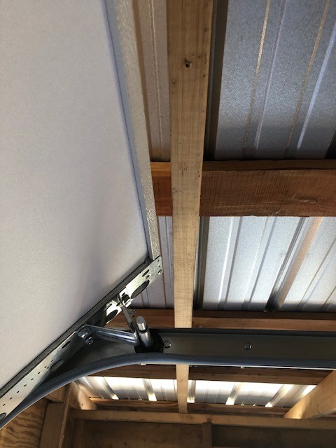

I hit a snag installing the garage door. The door hits the first rafter on the low side. I did manage to get he door up by removing the first roller and bracket and replaced it after it passed the first rafter. It seemed to clear the other rafters ok after the door made it's turn. As I see it, I have two options. I can cut a notch in the first rafter, or spend $80 more and get the low headroom installation kit. I can't get a lot of info on it. Has anyone ever installed a garage door using a low headroom kit? I believe I can get the door to go up and down without it. I'm not sure if there's enough room for the springs and such. I assume the low headroom kit will work because that's what it's supposed to do. I like to hear from someone who knows, Thanks.

Post Options Post Options   Thanks (0) Thanks(0)   Quote 200 10and20 Quote  Post ReplyReply Direct Link To This Post Posted: 25 Nov 2019 at 7:26pm
Rance yes a lowheadroom kit will work very easy to install. If I knew how to post pics on here I would show them on my on my old shop doors.
