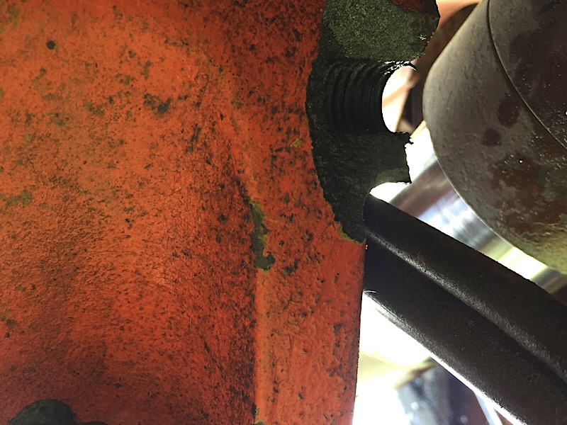

I was finishing up some plowing with my early One Eighty and 3-16 plow, when I backed into a dead furrow and heard a loud bang. I looked back and the plow had dropped to the ground and oil was spraying everywhere. I figured that the hydraulic hose to the left hand lift cylinder had burst until I took a closer look and saw that the cylinder mounting bracket was separated from the transmission housing. Evidently the bolts had been broken by the previous owner who had replaced two of them but not the third, which was still broken off in the transmission housing. When I backed into tha dead furrow, one bolt sheared off, and the other one broke the transmission housing ear off.
The rest of the tractor isn't too bad. It has brand new rear tires, decent fronts, good rims, fair sheet metal, a pretty nice running engine,etc. Other problems are that it jumps out of third with a load, the PTO brake is weak, and the seat suspension is kinda floppy. I suppose it's a good opportunity to fix the transmission but I'm not sure if I really want to put that much time and money into it. Anybody else been here and done this before?

If you scrap it do you need to replace it? Is so are you going to be able to replace it for what it would cost to fix the current one? Unless you're going to get a new (or at least a late model) tractor, I think you're better off fixing the problem. You know the tractor and at least it's recent history. You fix all that needs fixing you'll have a solid tractor for years. You buy a used one and you don't know what you're getting. A year from now you're new to you tractor could be in the same shape (minus the broken transmission housing). Not familiar with the 180 but if it has the Perkins engine and it's solid the decision gets easier in my opinion as those engines are solid. Fix it and you'll be in good shape for years.

Find a good welder/ machine shop and have them weld it back together, no big deal, been done before

We broke the rear housing on the case2096 last year. It was a lot of work to take the tractor apart and have the housing welded. After re assembly it's as good as before. Since you don't have oil pouring out it dosent look that bad. A good welder should be able to weld that once you take enough stuff off to get good access.

I'm with Tony on his thinking, also what are your shop capabilities? if you are willing to do the work it would be a good time to fix the tranny. as far as welding up your housing I would say that depends on the skill of your local welder if he has experiance doing this type of welding.

I've welded a lot of castings mostly on JDs were the drawbar rack attaches and JD has bad cast iron. Now on the other hand on A-C cast is a better type of cast is nice to weld it is more like a cast steel.  I wouldn't be afaid to weld it.

My dad welded up several cast iron blocks and heads on cars and trucks. He would heat the area with a cutting torch, weld with 7018 LH rod, then bring the temperature down slowly with the torch , gradually reducing the amount of heating with the torch. Later in life he would use a cast iron application rod in lieu of the 7018 rod.

I use an air needle scaler to remove sl*g and to relieve stresses in metal, as I weld.
If your shop skills are not as good as you hope, have a certified welder do the job.

I have had good luck with Hobart nickle 55 cast iron rods. Use an old Lincoln AC welder set to 75A with these rods.
