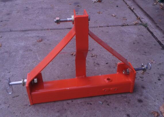

I made a 3pt to sleeve hitch adapter so I can pull my 10" plow with my 720. It had no problem turning over about an acre of old barn yard with turf tires. 20131023_130940-1.jpg
