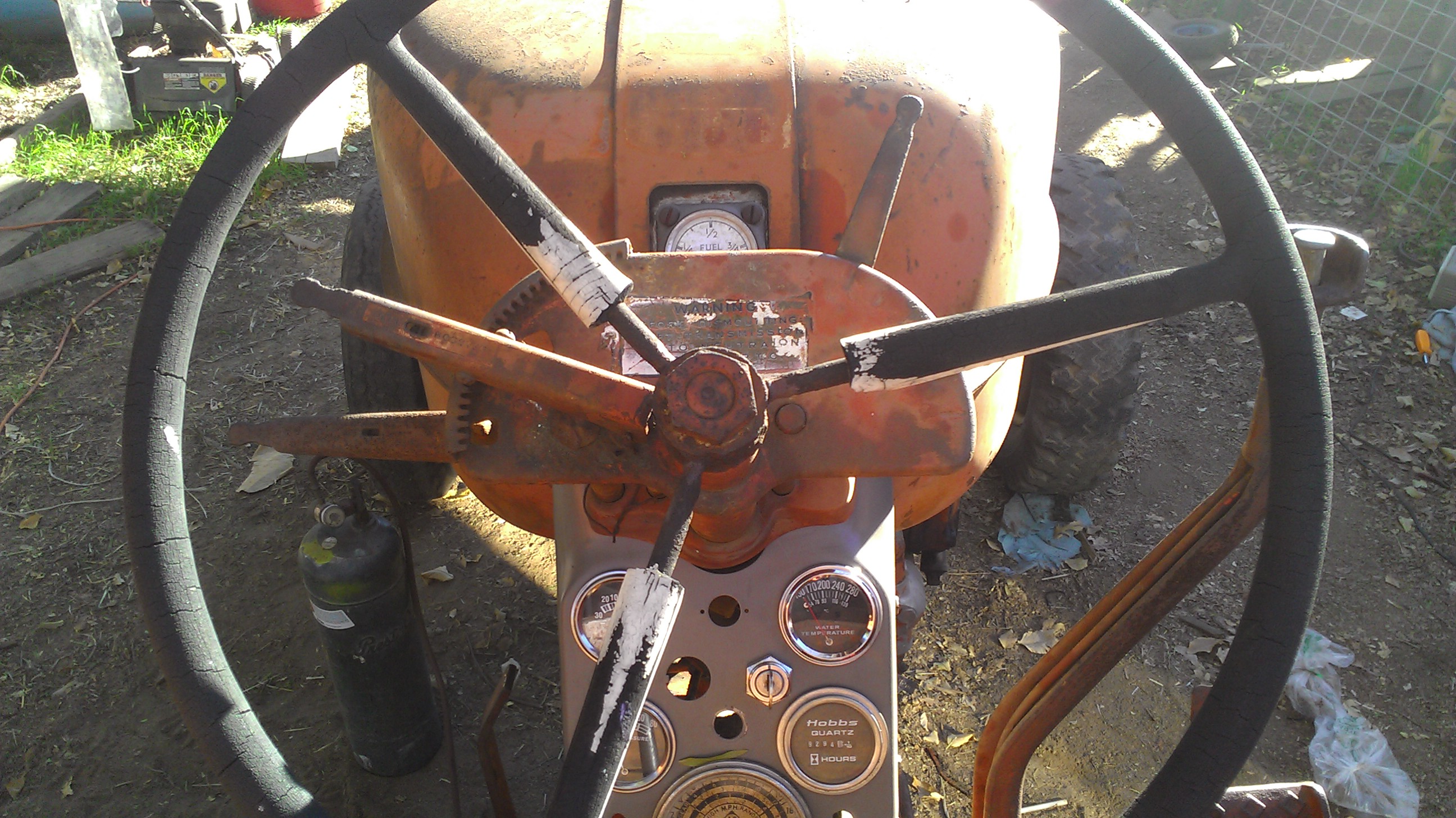

dave on the levers is the one with the 2 detents the raise and lower and the one with the saw tooth-ish  stops the pressure one

Yes, the lower is the raise/hold/lower. The other is a pressure adjustment, but it's only pressure against a load being pulled. So if your not applying a load from a plow or something you'll not notice any adjustment when moving this lever.

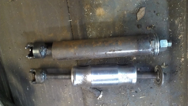

well got some stuff done today the brakes were shot well they still are but now they work, until the linings get here. got the pin out with the 2 tools i made. the shoes were froze to it. I could not get the pedal linkage out, froze also, so after that broke i was able to get all the brake parts out and cleaned up. repaired the linkage  and antisiezed it all... when i get the linings im going to bead blast everything and maybe powdercoat it. is that a bad idea with heat buildup?

one side came out pretty easy with the slide hammer puller the other side was a bear i had to make another puller with a threaded rod.

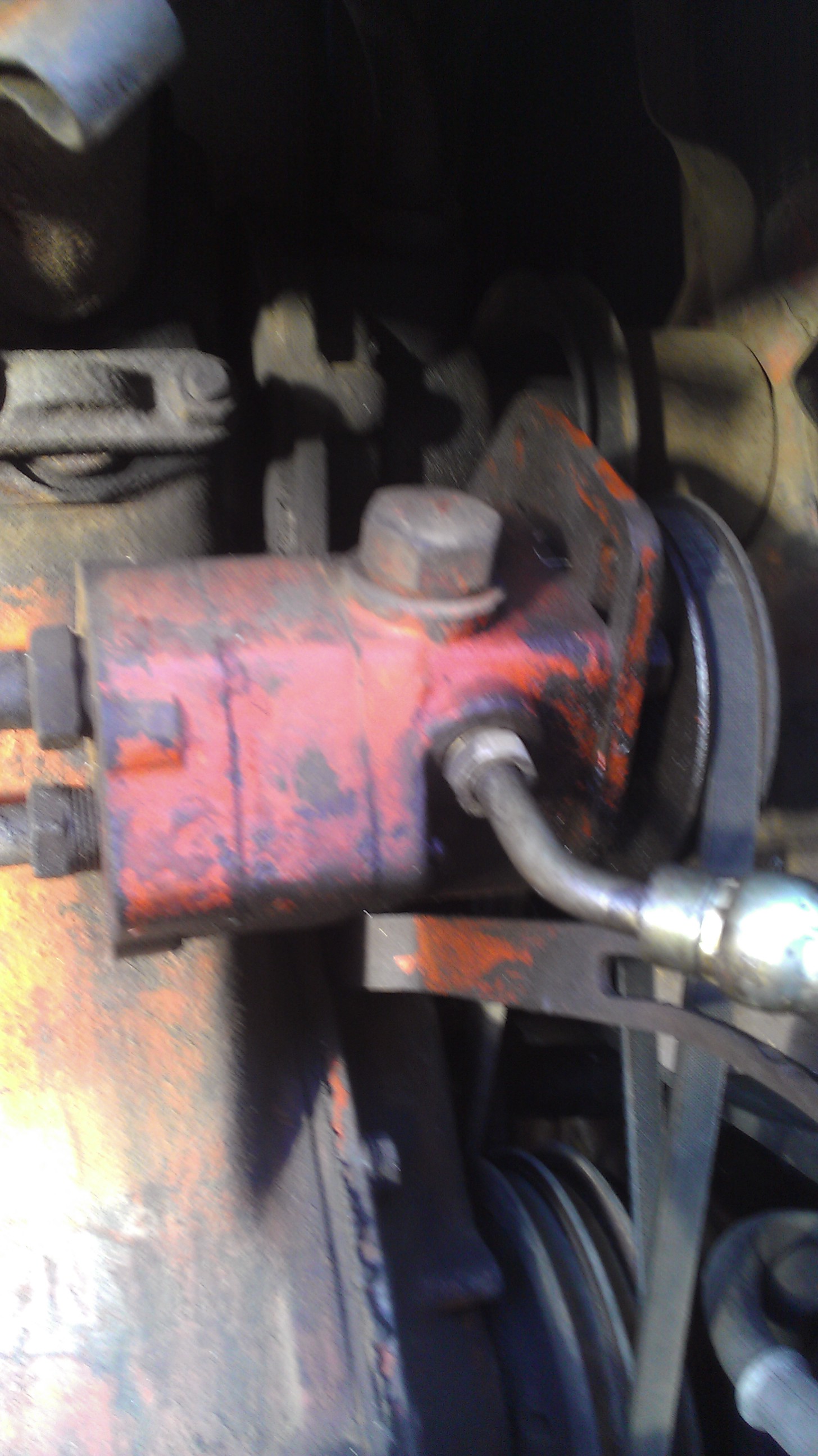

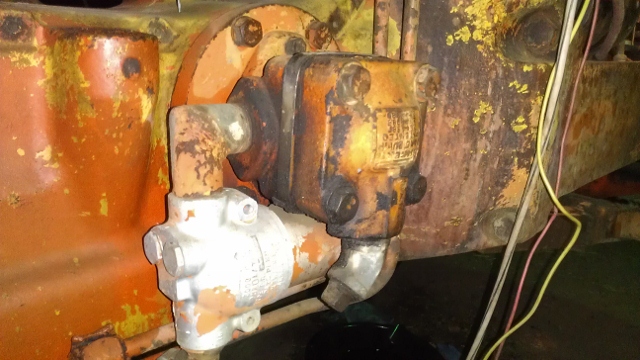

this is the hydraulic pump that is where the belt pully was,... is this a stock pump or an add on? on a different note  i took the power steering pump apart (seal gets here on thursday) there is a groove where the outer lip rides . can i not seat the seal as far, or just clean it up real good and let it ride.  or any way to fix the shaft? too poor to buy a new gear..

Nothing like I've ever seen. I'd say it's a real nice setup of non-oem parts.
You can install the seal away from the worn groove as long as it's far enough away from the groove so it doen't want to track back into the groove.

thank you dave  and does this thing turn on with the black handle on the dash?

If you have the Belt Pulley Knob on the dash, yes it should, unless something on the inside was modified as well, but highly unlikely.

You might want to put a "speedy sleeve" on the shaft if you have a bad groove. If the seal you get is a double groove, and you can measure it before installing it, you may be able to straddle it between the two lips and it will work fine.
