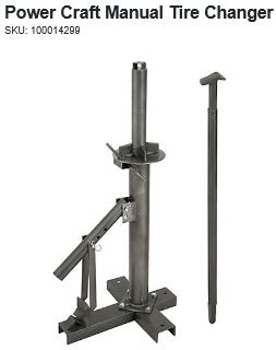

Bought me self a tire machine today
HD6GTOM View Drop Down
Joined: 30 Nov 2009
Location: MADISON CO IA
Points: 6627
Post Options Post Options   Thanks (0) Thanks(0)   Quote HD6GTOM Quote  Post ReplyReply Direct Link To This Post Topic: Bought me self a tire machine today
    Posted: 18 Apr 2020 at 7:33pm
For them dam lawn mower tires. Then, I bought the wrong size tires. I gots ta find a 1/4" plate about 14"x14" to bolt to the bottom of this thing. Then I can clamp it in the rim clamp tire machine and not have it taking up room on one of my benches. Gots ta head back to TSC tomorrow and trade tires. I had the right size in my hands and put them back. Sorts ticks me off at myself. Need to remind myself to pick up a half doz short valve stems. Dad ratted short memory anyway. Hoping you are all having a great day.

 Hey Tom,,,and here I thought I was the only"ist one to always fight them dang small tires,,,,, Some time ago ,,I bought the one Harbor Freight sells for the car and trk tires and after some modifications it works pretty darn good,,but you cannot use it on lawn mower tires,,,,,PFFFTttttt,,,!!!
 Can you post a pic of the one you bought ,,,,at TSC,,,??

 Hey Chask,,That is the exact one I bought at HF and it works many wonderfuls on the car and trk tires ,,,but will not work on the smaller tires. I thought it was ole Tom that had bought one strictly for lawn mower tires,,,???

That's the only one they showed on their online shopping. Maybe they have a smaller one in some stores. I believe it said it would do 8" rims. Harbor freight has them small ones for $37.99 with coupon right now I see.
Coupon 39506312. Use In-Store or Online

I think its easier to buy it, than build it, but here's a link:

Guys I may have miss lead you guys. The little tire machine came from H.F. mower tires came from TSC. Just Google HF. The picture of it comes up. I did put it in the vise, but it makes it so high that it is hard to get any leverage to mount/demount the tires. My welder man is making me a 14"x 14" x 1/4" thick square plate. I will bolt it to the plate and clamp it in my rim clamp tire machine. That will make it about 15" lower and be easier to use. It is not a unit for a professional tire shop, I had 1 of those in the tire shop. This one is good for A home owners garage/shop. Dam JD yellow paint. I had to take the left tire off and put a tube in it. The dang paint was coming off the inside of the rim and I could not get the bead to seal. DYDave that's it thanks you for posting the link. I don't know how to do it.
