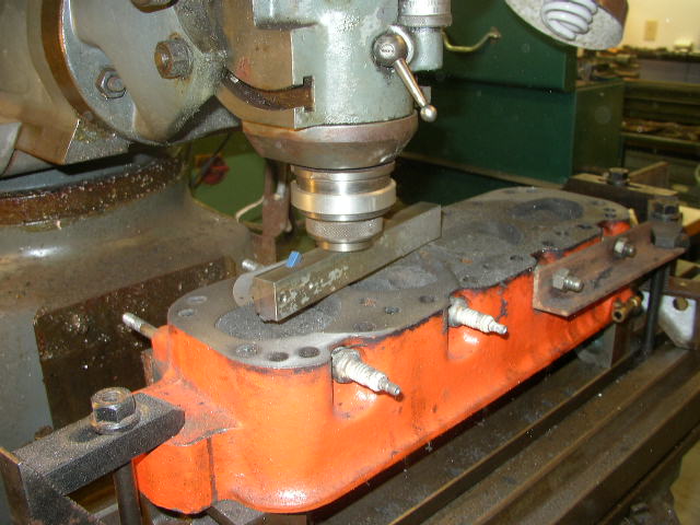

Post Options Post Options   Thanks (0) Thanks(0)   Quote SteveC(NS) Quote  Post ReplyReply Direct Link To This Post Posted: 30 Jan 2012 at 3:40pm
Thanks Dick,
I know what a cold shop is like. Today, however, I turned on the heater and lit the little Jotul so I could do some work.
Here's a shot of the first cut off the head.
