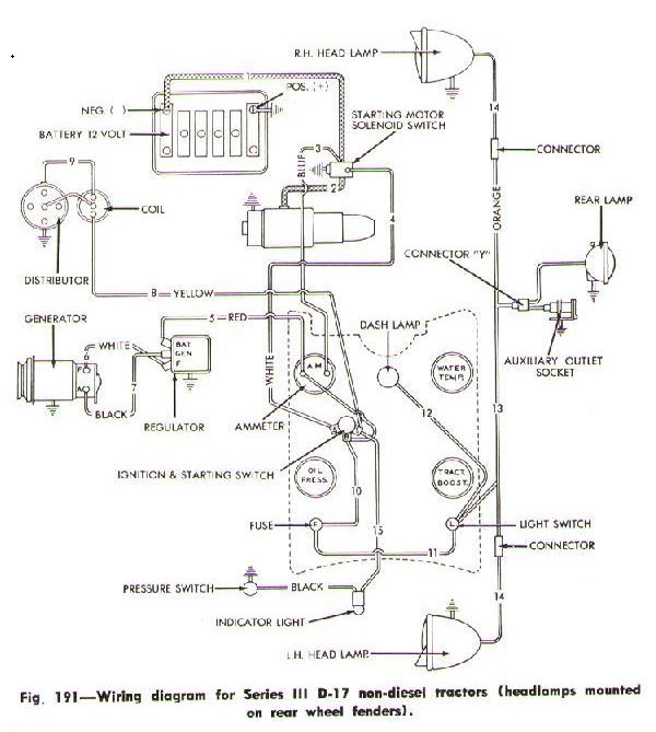

Looks like a BLUE wire from Battery cable to ammeter .... then red wire from there to regulator ...... If you take the red wire off you can test the generator and regulator..... there is another wire on the RED terminal of the ammeter.. If you take that wire off, it stops power to the ignition switch / lights so your testing that circuit.

Post Options Post Options   Thanks (0) Thanks(0)   Quote JWingerter Quote  Post ReplyReply Direct Link To This Post Posted: 17 Sep 2022 at 8:14pm
Referring to the circuit diagram above...
Why is this showing positive ground?  I thought things were negative ground.

Points: 88242
Post Options Post Options   Thanks (0) Thanks(0)   Quote steve(ill) Quote  Post ReplyReply Direct Link To This Post Posted: 17 Sep 2022 at 8:19pm
cars, trucks and tractors were all POSITIVE ground in the 1940- 50 era... Many were 6 volts.... about 1960 things started to change and systems were converted to NEGATIVE ground and 12 volts.... by the 1970s things had switched to ALTERNATORS instead of GENERATORS and the standard was 12v NEGATIVE GROUND.
What is yours ?  It was original POS GROUND... could have been changed over the years... not hard to do... and some had an ALTERNATOR installed in place of the Gennerator.
