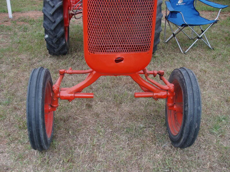

Were you thinking of something like this ?

They had that type early and ten later offered a square beam of the type seen on a CA.

John. You got it right
    The 39 B in my barn has the Arched Adjustable. It has been set to its narrowest setting so long it won't adjust anymore. The parts books show them in two Arched Adjustable versions. 43" - 48" tread  and the RARE 50" - 60".  I only know of one belonging to a forum member.
    Arched Adjustables were dropped in favor of the adjustable tall spindle straight axle also in 2 width versions in 1940 and after. The wider one became available in 1942
