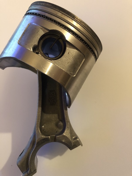

   Well,,as usual, ole Steve almost hits it on the head,,,I figured to atart at the easiest so I poured some gasoline on the combustion chamber and waited,,,and waited,,,and the friggin valves are not leaking thru,,,,!
  I figured to look at the rings and would go no farther. Took engine out of frame in bout 20 minutes and this block has an end plate that makes it plumb easy to remove the piston and rod and seen the problem right quick!!  The frigging rings are all STUCK!  Can't figure why,,,the cylinder nor the piston are not scored a bit,,,,SOOooo,,what happened for ALL the rings to get stuck???

I had a small B Allis the the lower radiator hose broke and let a gallon of water leak out while mowing... Motor overheated and LOCKED UP... Took apart and the rings were STUCK in the pistons .......... no other damage................Overheating/ slightly warped.....

Ring grooves machined too narrow.
Worn lathe tool, missed replacement.
Carbon filled the gaps and grips the rings.

As JVIN said- ring clearance in groove wasn't sufficient.
A fix?  pick the rings loose, pop out the pin and rod, CAREFULLY chuck the piston in lathe at the skirt (pad the jaws with strips of soft wood), and dial it in true... then skim a few thou out of the ring grooves with a SHARP HSS bit...
Another way would be to put valve grinding compound in the groove and work the rings, but that'll take a while... and risk getting grit embedded in the aluminum.

 I had sprayed some carb cleaner several times on the piston and finally worked the two compression rings loose on the piston and spun em off.  The oil rings came off pretty easy.  Run the compression rings down in cylinder and both have good end gap clearance.
  Ole JVIN hit it good as there was lots of carbon looking Gookies in the ring lands. When I DID break the rings loose from piston, they sprung out but would hang up when pushed back into ring land,,,,,
 To Dave Kamp,,what I had in mind but I do not have that narrow a tool, as the rings are very narrow,,almost paper thin, haven't calipered them yet, even my narroest  cut off tool is twice as wide as the lands,,,,,maybe I can spin the piston in my lathe and get an old oil ring and use as a cutter,,,,?  Also, thinking of getting afull sheet of say, 320 sandpaper and try polishing the rings,,,??

dang, us reglar folks would use a fine hacksaw blade to make the grooves wider.....
