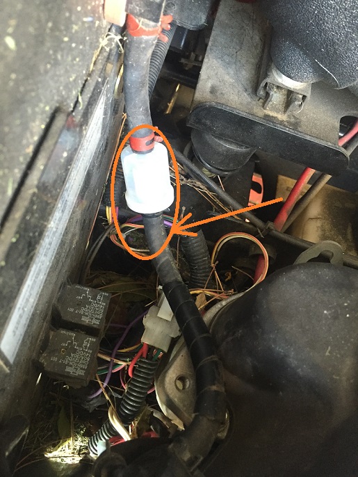

Went to town today and got a new filter, during replacing I may have stumbled on to one of the problems as the float improved operation.  Noticed the tubing has a pretty good bend in it, probably could hold up while it was new  but age being a factor I'm thinking the pump sucks it shut once the heat gets to it.
Points: 25247
Post Options Post Options   Thanks (0) Thanks(0)   Quote jaybmiller Quote  Post ReplyReply Direct Link To This Post Posted: 15 Sep 2019 at 6:12pm
I'd shorten the top hose to minimum, to allow the bottom one to be longer for a more gentle bend. Tight bends are bad news, might take 3-4 years but tubing will collapse.
If that doesn't work out, grab a section of brake line, bend as required and connect to 2 'stubs' of rubber hose.
'Fuel injector' hose has a stronger 'sidewall'( good for high pressure ) so it won't collapse.

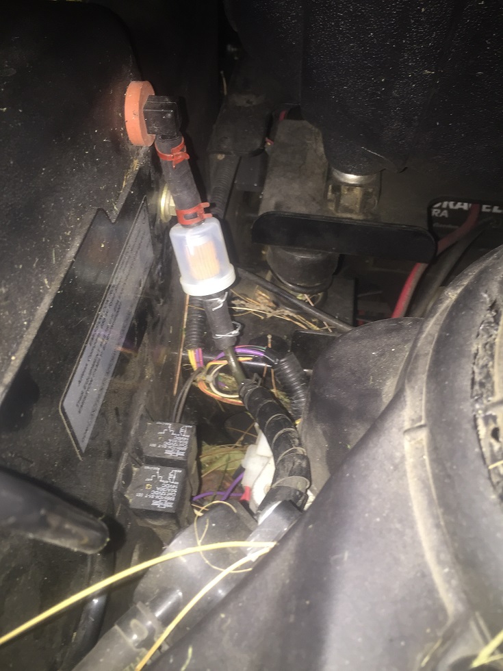

Well, between Dave in PA and jaybmiller it is fixed.  I shortened the hose between the tank and filter, installed a new filter, put a short piece of hose on the outlet of the filter and then used brake line, bent at a 90 into the hose to the pump.  The amazing thing is that not only did I have a short piece of brake line that fit but I knew exactly where it was.  Thanks a lot guys, mowed for 3-1/2 hours straight and not so much as a hiccup.
Didn't have any small hose clamps so I put some temporary clamps on.  However, as a boss I had years ago once said, "Nothing is so permanent as a temporary repair."
