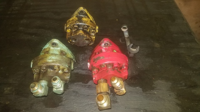

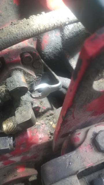

Real SOB to extract the fuel pump from this engine but the shuttle valve internal, (pressure relief) was jammed in it's bore from the biodiesel crap. I'll get it reinstalled later today and the problem should be history.
Red pump on right is original to engine. Green pump is known good from a blown 8V-71 engine, yellow pump is known good from my 3-53 powered backhoe. It too had a stuck shuttle piston and was replaced with a rebuilt pump several years ago. Wrench on right is an orphan from the toolbox to bend up into something I could use for this task:
Wrench in use. 1/2" drive ratchet in the open end made easy work of breaking that hidden fastener loose:

By the picture are you saying an 8-71 and 3-53 use the same pump? Because they look very much the same to me.

They can use the same pump if the rotation direction is the same. Dependent upon blower, governor location, and engine rotation on the engines determines either right, or left rotation. There are standard variants, and high flow for higher horse applications.
These are two gear pumps just like an oil pump in an engine. There is a sliding shuttle valve that is spring loaded to relieve excess pressure in the system when the pump is supplying more fuel than the engine is burning. In reality when the valve operates, this temporarily disallows vacuum, or suction on the line through the primary filter till the excess pressure decays and the spring loaded shuttle valve slides back over a port allowing the pump to draw again. This is done by uncovering the port that bleeds pump discharge into the pump suction side. The shuttle valve, and bore this valve slides in wear over time. In my case, the plunger valve, pressure relieving spring, and stroke limit pin are all worn in, and out.

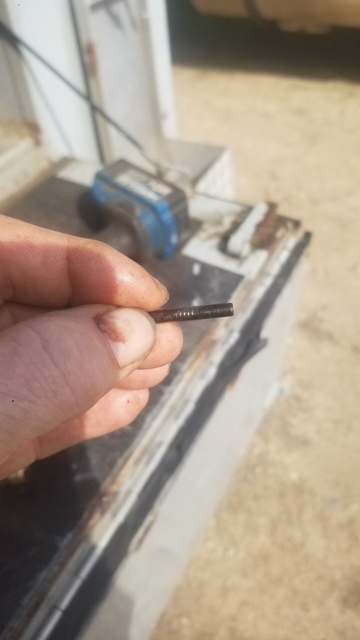

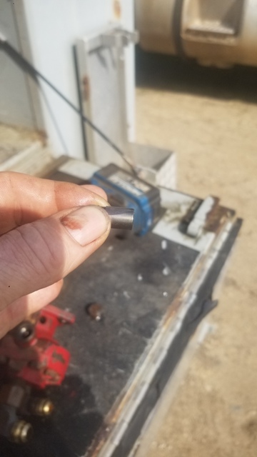

This is the shuttle:
This is the relief spring:
The stroke limit pin had the spring coils worn into it. The shuttle and it's bore has grooves worn into them. Can't really tell by the low resolution of the posted photos but they are pronounced.
