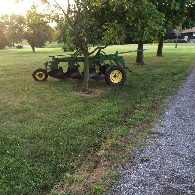

What JD 3 x 16 plow did you get? I have a trailer set that are sweet to use. I do love the Allis semi mount 4 bottom but my father had to modify some Oliver cover boards to do a nice job. Now they can turn over 4-5’ rye. My little JD does not handle tall material well but does really make a smooth, level job.

I’ve got a Deere 3-16 semi mounted, I’ve had it for a few years. It does ok but it’s a trip bottom and they don’t really work especially in all the rocks I have.

They’re not seized, I can trip them from the back with a wrench to tip the bottoms to change parts. The problem is their is a round shim that goes over a roller cam on the inside and I think the shim is broken/gone. The middle bottom is tipped down about an inch and a half lower on the point that the rest of them so I get a “ridge” from that deeper bottom. I got it with the intension of replacing the plow after a few years but just haven’t done it yet.
