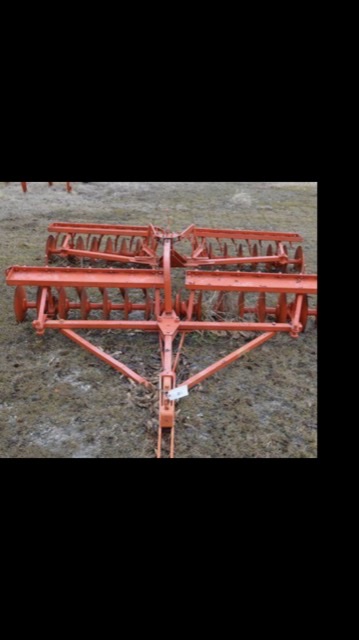

I have a 8 ft drag disk and the bearings are out on the front left gang. Does anyone know where to get them or if they are available??
will try and a attach a picture
Thanks

The old Allis drag disks like that that I see have wood block bushings not bearing. You could make your own wood block or get some poly bars from McMastercar and made your own. They have some especially slippery ones designed to be used as bushings.

Call Gary Agrimson. I think he had some plastic bearings made.
763-566-3446

Pretty sure these are metal bearings with grease zerks

Take another look. There's an Allis drag disk at Grandpa's. I think it's wood blocks with grease zerks. The balpak bearings used by Allis a little later weren't greaseable.

These have a cast outer housing and there will is a metal inner race on the gang shaft I will try and get pictures

Take a look in the knowledgebase section. There is an article on rebuilding the balpak bearings. It has some pictures and you can see if they match what you have.
Are these drag disks rare? I know of several but I think generally these are getting scrapped by now. Neat old pieces but not very useful anymore.
