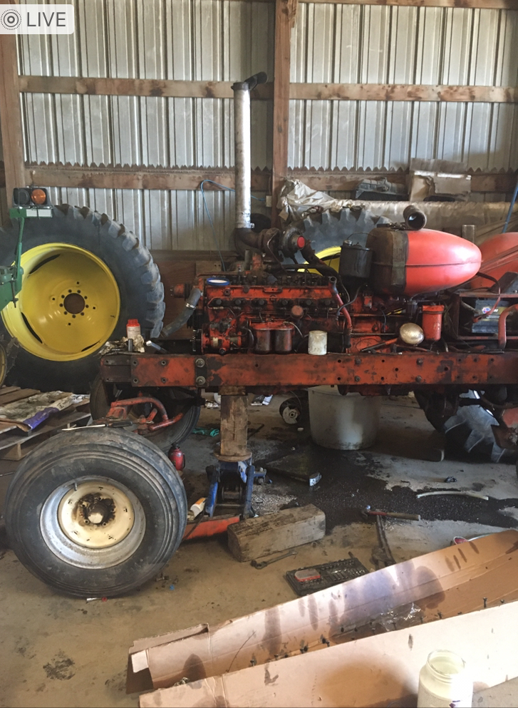

Got the timing cover off by Loosening the frame rail and it came right off. Got the head on and the manifolds. Now just waiting on parts.

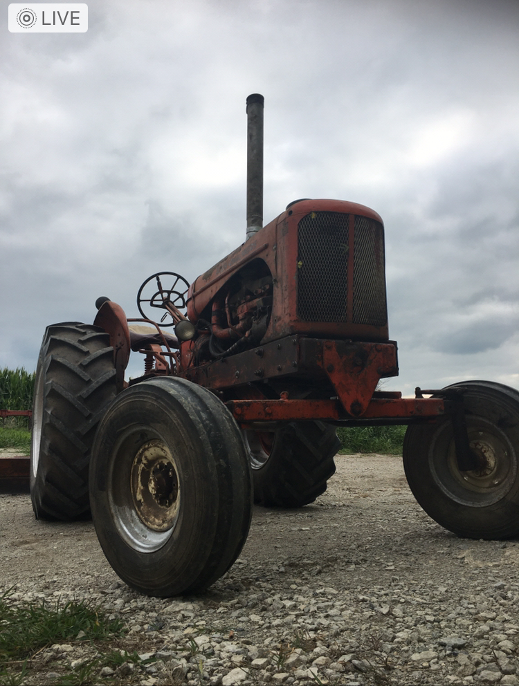

Got it all back together today and it ran nice and smooth.
Will send a picture of it , don’t have a updated picture yet.

Here it is after two hours of running. The injection pump is leaking a little but not enough to worry about.

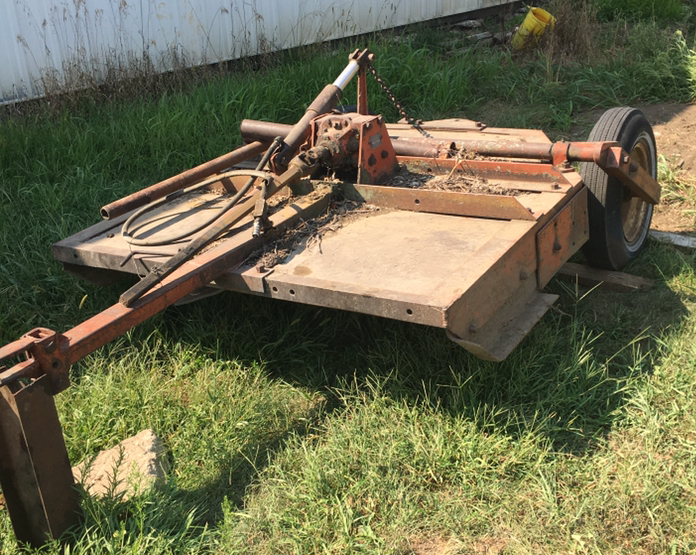

Got a mower for it, an Allis Chalmers 160 rotary mower although it blew a tire on the way home and has barbwire wrapped around the blade.

Nice score!I see it has the optional shredder blades on it.Do you have a not so close up pic of it?

Here’s a full picture of it.

Have to put new seals in it but it shouldn’t be that bad to do.
The barb wire tore the seal up so another good project to get done.
Points: 8689
Post Options Post Options   Thanks (0) Thanks(0)   Quote Sugarmaker Quote  Post ReplyReply Direct Link To This Post Posted: 25 Aug 2020 at 6:43am
55,
Looks heavy duty. At my age I would be adding a jack to that unit.
Loos solid and not all rusted out.
