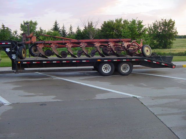

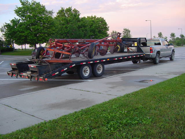

Would this be the 9000?  #9765?? I think they said the hitch is set for D21 on land...Dale
Calvin Schmidt View Drop Down
Location: Ontario Can.
Points: 4572
Post Options Post Options   Thanks (0) Thanks(0)   Quote Calvin Schmidt Quote  Post ReplyReply Direct Link To This Post Posted: 16 hours 11 minutes ago at 3:22pm
Orrangereborn, I'm sure that you have a 9000 series plow on the trailer.
