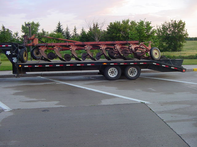

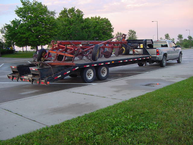

Would this be the 9000?  #9765?? I think they said the hitch is set for D21 on land...Dale
Calvin Schmidt View Drop Down
Location: Ontario Can.
Points: 4572
Post Options Post Options   Thanks (0) Thanks(0)   Quote Calvin Schmidt Quote  Post ReplyReply Direct Link To This Post Posted: 4 hours 54 minutes ago at 3:22pm
Orrangereborn, I'm sure that you have a 9000 series plow on the trailer.
I have a 3000 series 7 furrow semi mount 3pt on land hitch plow with auto resets.
I have never plowed with it. 3000 series are all 16" with 3pt semi mount on land hitch.
2500 series are 18" trailer plows only.
