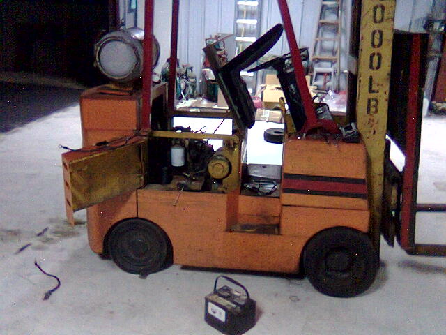

I traded out for an Allis Chalmers forklift and neither the former owner nor myself knows what model it is. There's no data plate that I've been able to find. From pics I've seen in the used markets, it could be early 70's or very early 80's. I know it has a flat head motor and a 4K lift spec. Also, if anyone knows, do you check the trans fluid when its running like a car or when its shut down? And which ATF would it take? Would it being low affect its ability to go uphill and would that account for the brakes not working? The emergency brake is quite strong but the foot brake does nothing. Thanks for the help.

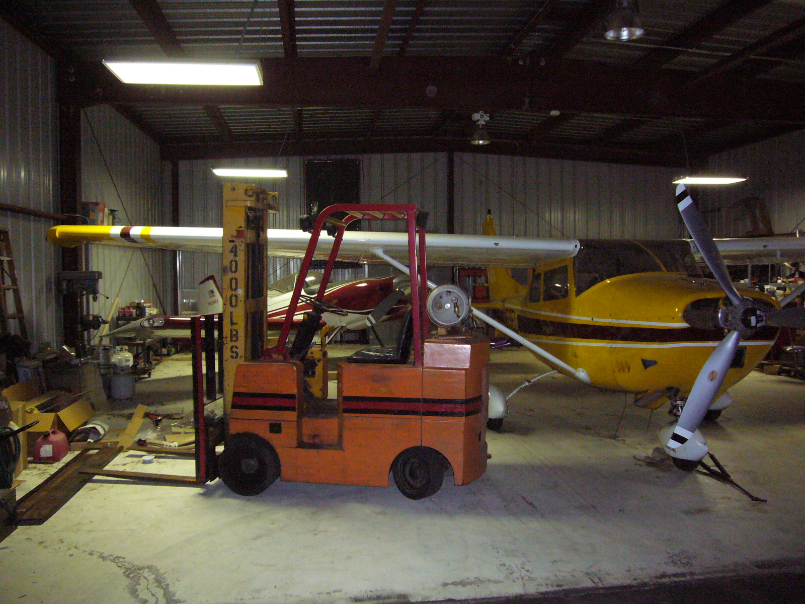

And here it is from the other side with everything intact

http://www.msusurplusstore.com/servlet/Detail?no=3750
Here is one that looks pretty close, ACC50.

It is likely a ACC40 and the engine is a Continental

I've had two A-C forklifts much like yours, very good units I might add. The brakes don't have anything to do with the trans. Under the floor panel is a master cylinder that is probably low on brake fluid. Likely a slow leak somewhere. Add fluid and pump the pedal 'til you feel the pedal coming up. Check for leaks underneath and by the drive wheels.
Make sure the inching pedal (clutch pedal) is not sticky and has full movement, if it's not up all the way it cuts part of the drive power especially noticeable uphill and do top up the oil in the forward reverser.
