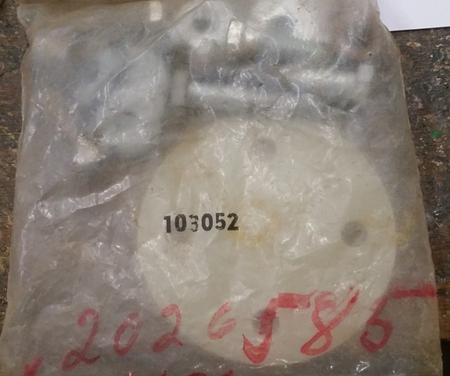

An in stock item at most Simplicity dealers! Same disc used on all the L&G tractors. You can double them up for extra strength when pulling. And as Mike said they also have a coupler steel spacers and Heavy flat washers used on them. I've got a new old stock kit #103052 with new bolts, HD washers 1 disc and spacers left for $30.00 plus $8.00 postage
online they want $37.75 plus shipping for them.

Can you show me a picture farmtoybuilder we stock them separate. Never seen the kit

The disc is 2 1/2" centers. Yes we accept pay pal. Email us direct at farmtoys@sbcglobal.net I'll try posting a picture. You can purchase just the disc from dealers. I don't have any separate ones left. I should probably keep this one as we use a few of ours too! Let us know if you want it.

That's not the part I need. I need the cast iron part that bolts to the flywheel.

I thought you broke the disc. As that's common! Have never broken a hub. I don't have any of them.
