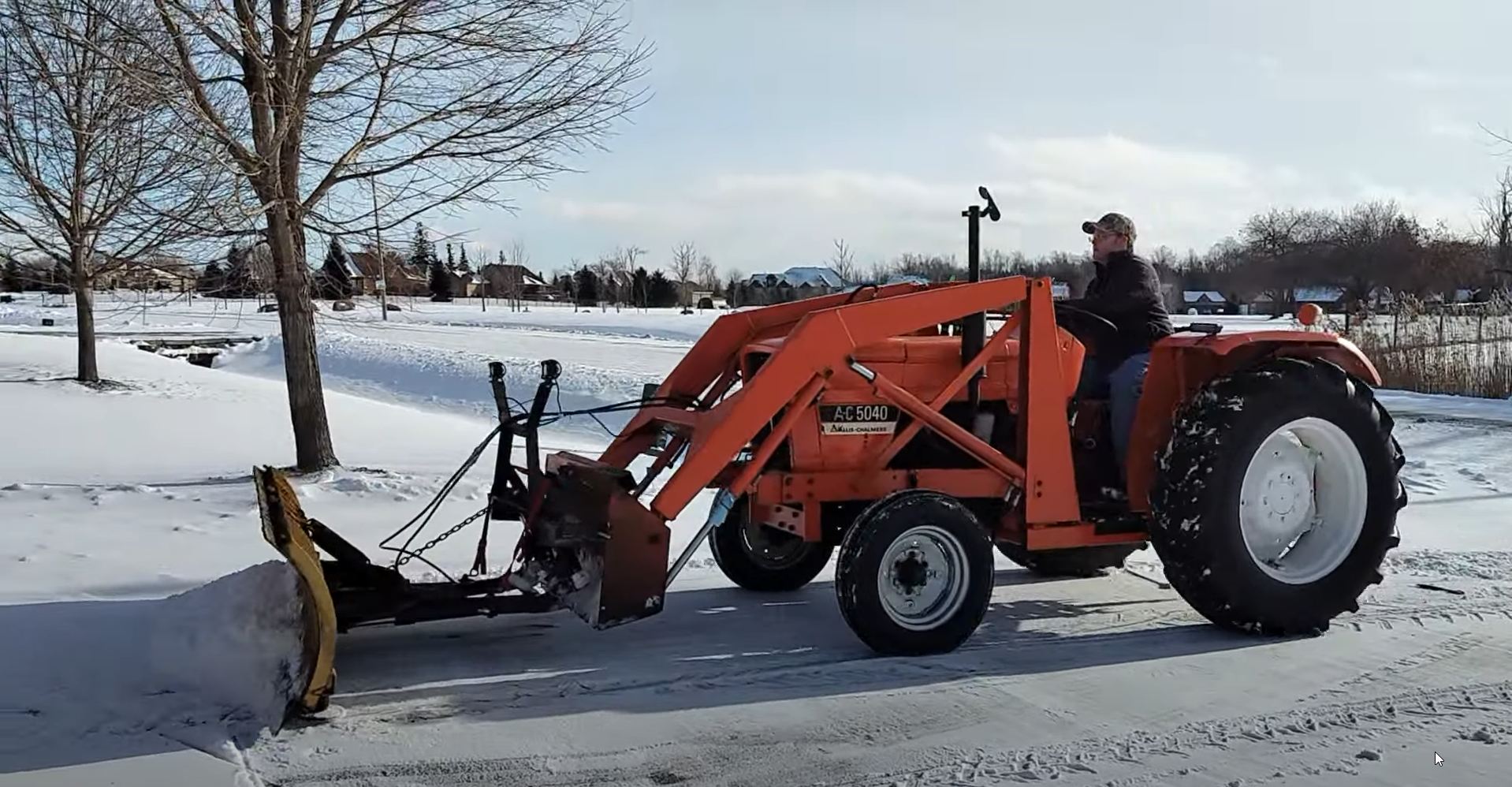

Thanks Jason,
The pictures in this thread is what mounts to the tractor.  It is a standard size.  SAE A Two Bolt Flange.
I do have a new pump, same flange just different shaft size.  5/8 instead of 11/16.  I am going to make up a bushing to take up the space.  Just have not done it yet.  The tractor is currently in use moving snow around so it will wait until spring.  There is a PTO mounted pump that works fine it just stops if you push the clutch down all the way, you just learn to work around it.
There was another thread I had started on this tractor.  it needed to be split and clutch work.  All that got done and came out great.
I have a google album I can share if people are interested (not sure if that is against any rules?) that has 100 pictures of the process.
