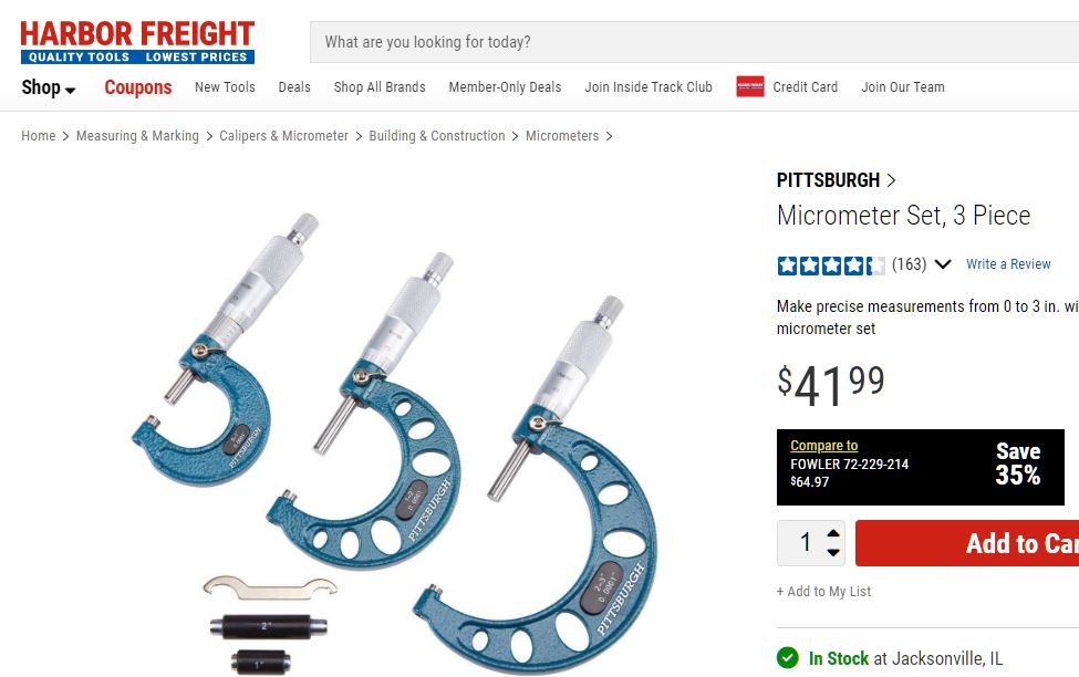

That is not a Caliper to use for checking a crank the proper way .

Post Options Post Options   Thanks (0) Thanks(0)   Quote steve(ill) Quote  Post ReplyReply Direct Link To This Post Posted: 06 Jun 2023 at 1:16pm
what Fred is suggesting is to purchase a micrometer set... You get ONE  that goes 0-1 inch, one that goes 1-2 inch and one that goes 2-3 inch... That should do everything on a B tractor Journal ...... But to check INTERNAL diameters, you would need a snap gauge or internal  set ...

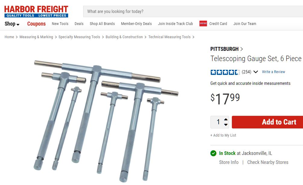

The QUALITY of measurements is 50% the TOOL and 50% WHO is using it.. I would agree a micrometer gives you more "FEEL"... but you can do quite a bit  INTERNAL and EXTERNAL with a caliper.
Edited by steve(ill) - 06 Jun 2023 at 4:36pm

Post Options Post Options   Thanks (0) Thanks(0)   Quote steve(ill) Quote  Post ReplyReply Direct Link To This Post Posted: 06 Jun 2023 at 1:21pm
internal gauge set to use with micrometers.... You can buy high quality much more expensive micrometers... I have a set that cost hundreds of dollars.... im just showing for reference, that you dont have to spend a fortune to get good measurements.

Close only counts in Horse Shoes , LOL  (depending on who you are playing )
