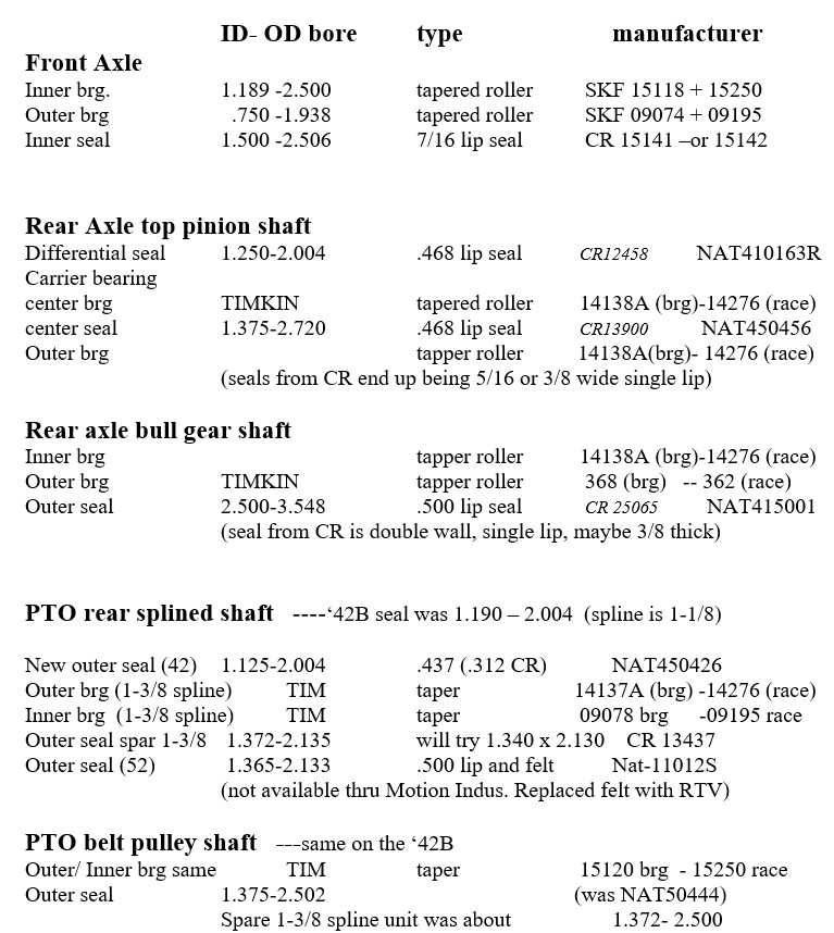

this is what i used years ago..........

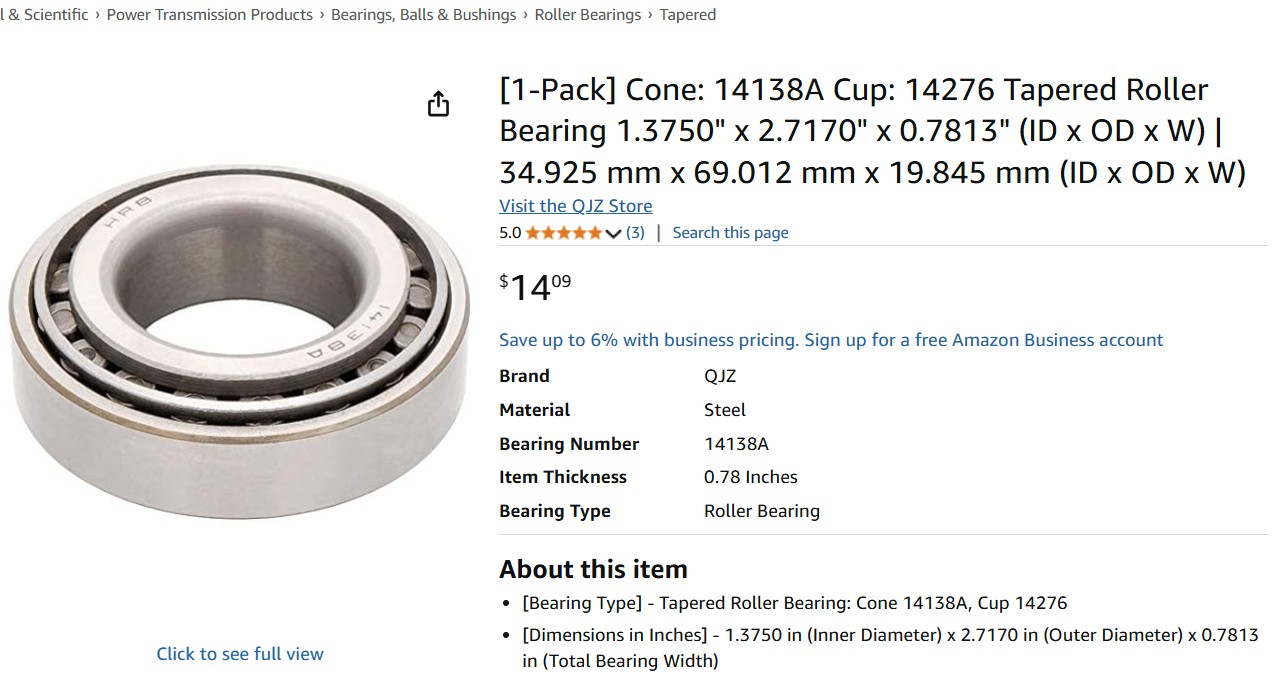

Yes! The bearing just behind the pinion retainer cap is what I need to replace

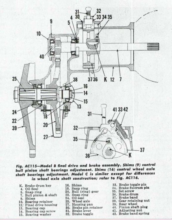

that should be the OUTER BEARING on the PINION SHAFT...
Edited by steve(ill) - 24 minutes ago at 8:16am
Points: 86362
Post Options Post Options   Thanks (0) Thanks(0)   Quote steve(ill) Quote  Post ReplyReply Direct Link To This Post Posted: 31 minutes ago at 8:09am
the above is AMAZON... you should buy the RACE too... Yes, the RACE is pounded into the 4 bolt cover... bearing is pressed onto the shaft.. You may need to HEAT or CUT to get the bearing off the shaft ... try a puller first..
There are SHIMS on the cover to adjust the end shake on the bearings ... hold the cover up to the case with bearings installed ( 2 bolts) and measure the GAP between the cover and housing.. You want MINIMAL clearance.. No "CRUSH"..
here is another option - e-bay...... you can also get at NAPA or local Auto Zone..
