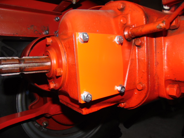

I don't have any systems on my B so I removed the hydraulic pump from my PTO.  It was easy.  I had some 3/8 aluminum flat stock and manufactured a nice cover plate.  Made a gasket and painted it.  Really cleaned up the back of the tractor and the best part, no more leaks.  I kept the pump just in case.
Edited by BEK - 27 Mar 2018 at 8:02am

Thanks for the info. I will look at the adjustment to see if I can get it to stop and just cap it but if it has to come off from something sticking I may just make one of those plates; that looks really clean. Thanks
