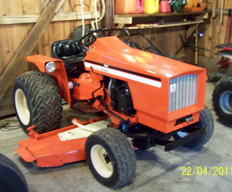

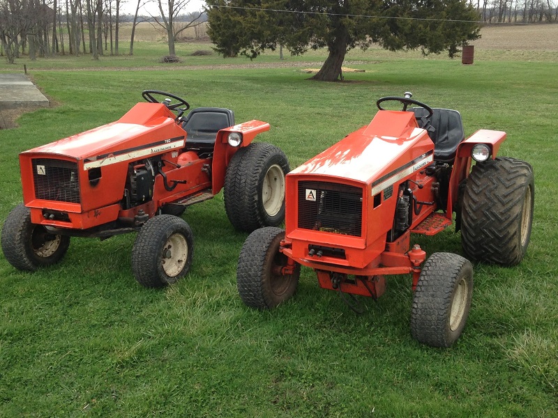

That's a sharp looking 720!
The one on the left we picked up at an auction.  Supposidly had been gone all thru but since we've acquired it we have done nothing but replace things lol.  The one on the right was my great grandfathers who purchased it new.  We acquired this one after my great aunt had sold her farm.
