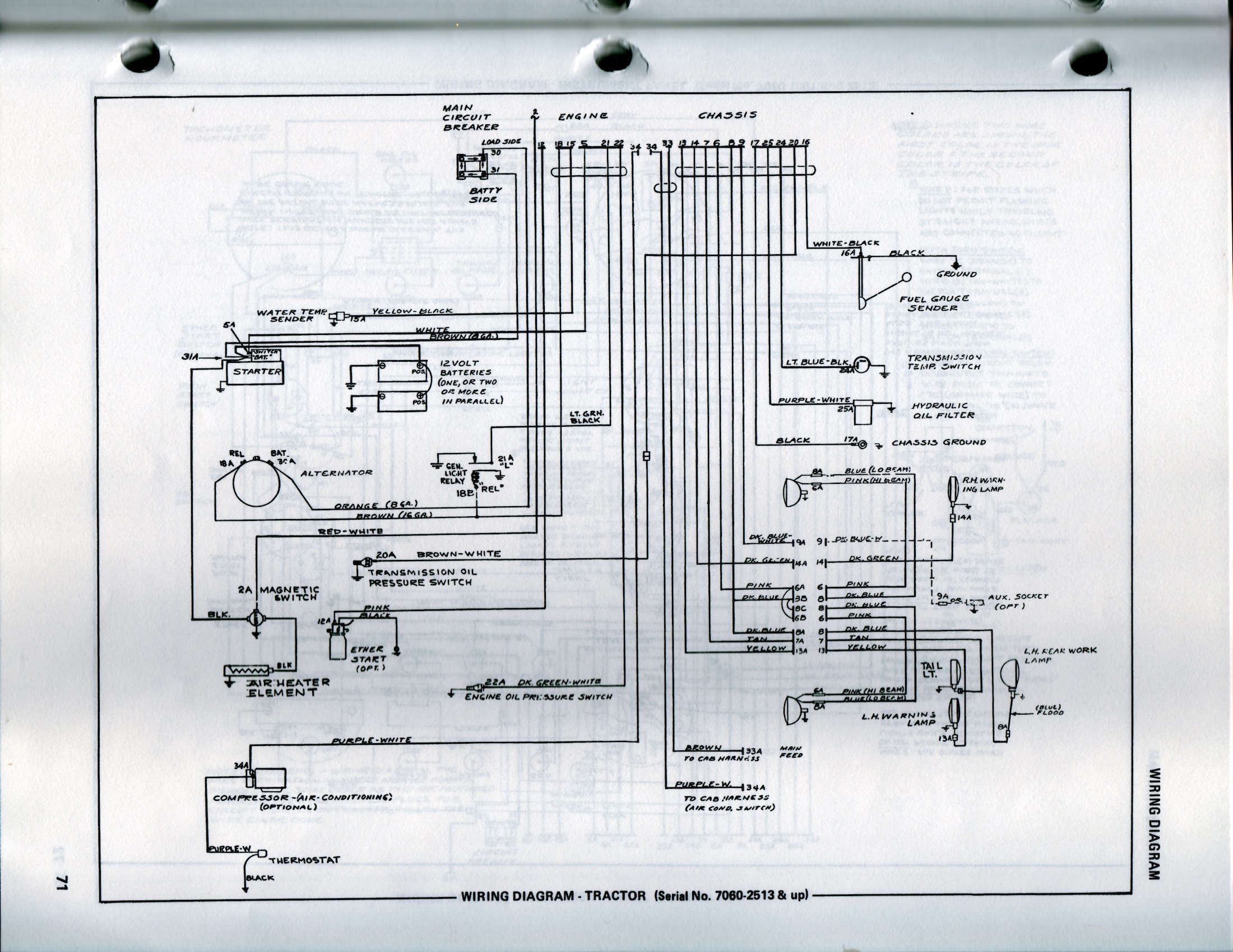

Wondering if anyone ​would have a schematic of a 7060s alternator wiring? Deco alt.Thanks.

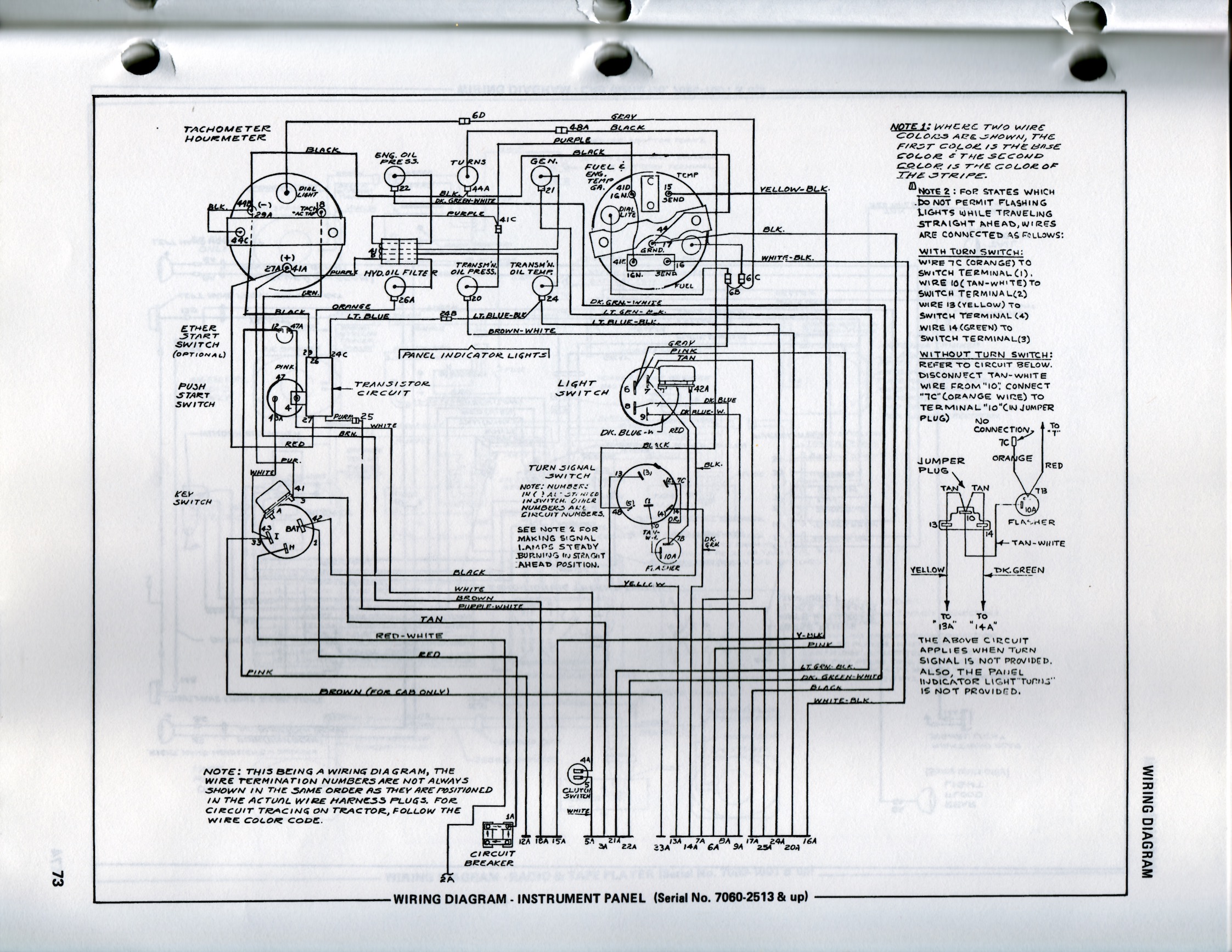

Depends on serial number.  Here is 2 of the different alternators and 2 of the key switch wiring.
