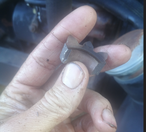

Thanks again for everyone's replies. As I should have guessed, I'm turning this tractor into a new project and am getting more eager to try and get it going - despite what I told myself when I bought it. Opened up the gear pump yesterday. The housing looks surprisingly un-marred. I realize that it's not the kind if thing you typically check only by eye, but I'm willing to put a new set of pump gears in it and see how it does. It sounds like Lynn has a set of usable gears he's willing to sell - just waiting to get a shipping price. The keyway on the shaft is a little damaged on the driving surface, but I'll bring it into our machine shop and have the keyway widened a smidge past the damaged region and have a custom stepped key made for it.
In the meantime, I'm guessing the gear pump failed from sucking up some debris and getting it wedged between the teeth and housing (or between gears). I'd really like to drain/clean the sump as best as I can. From what I gather from the schematic, the piston pump primarily gets supply oil from the gear pump as it returns from the steering/cooler? And it appears to return from the cooler and feed the piston pump via the second (RH) belly filter, so the oil has theoretically passed through two screen/filter steps before it gets to the piston pump? But (from what I understand) if flow from the gear pump is insufficient for the piston pump's demand, it appears that it will draw from the surge chamber, through no filter (or even an inlet screen). That seems a little odd, but I guess it's better than risking running it dry. I think I read somewhere in the manual (can't find the page now) that the surge chamber is directly open to the rest of the rear-end a few inches from the bottom?
I'd really like to reach in and clean inside both the main housing and surge chamber as best as I can. I think I can access most of the rear housing by removing the LH filter housing, but I'm wondering if there's a way to access the surge chamber?
Also wondering if it would be a stupid idea to put a couple of those ultra-strong rare-earth magnets in the rear end before I put the filter housing back in. Just an extra precaution to try and catch any metal still floating around. Stupid idea?

Post Options Post Options   Thanks (0) Thanks(0)   Quote DrAllis Quote  Post ReplyReply Direct Link To This Post Posted: 28 Oct 2025 at 6:09pm
The surge chamber gets filled by clean oil coming from the RH filter and passing thru the tube that feeds the piston pump (if it wants any oil) and if the piston pump isn't demanding oil, the oil then goes on to the surge chamber. It's like filling a bath tub. When the surge chamber is full, the clean oil spills over the wall into the rear main housing. I've never cleaned one. Never saw the need because it's clean oil that was pumped into it. Why the surge chamber??  If the piston pump is at full output, the charge oil from the RH filter cannot meet the 23 GPM flow of the piston pump. At this time, the piston pump draws oil from the surge chamber AND the RH filter to keep the piston pump happy. You can remove the left hand filter assembly and pretty easily clean the floor of the rear main housing. A couple of magnets in there on the floor sure wouldn't hurt anything.
