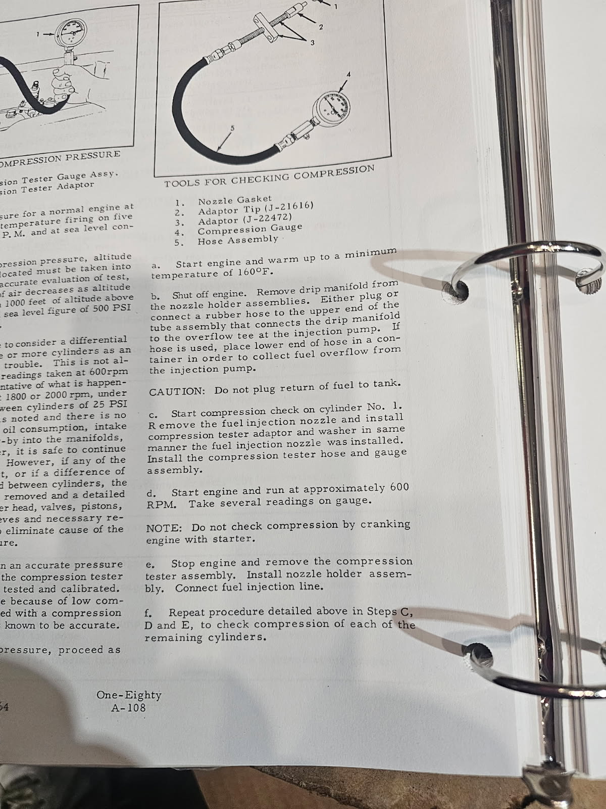

·         I measured compression with all injectors out using cranking speed and a cold engine. The cylinders range 200 to 210 psi across the 6 cylinders.
o   This evenness leads me to believe I don’t have one or two dead cylinders.

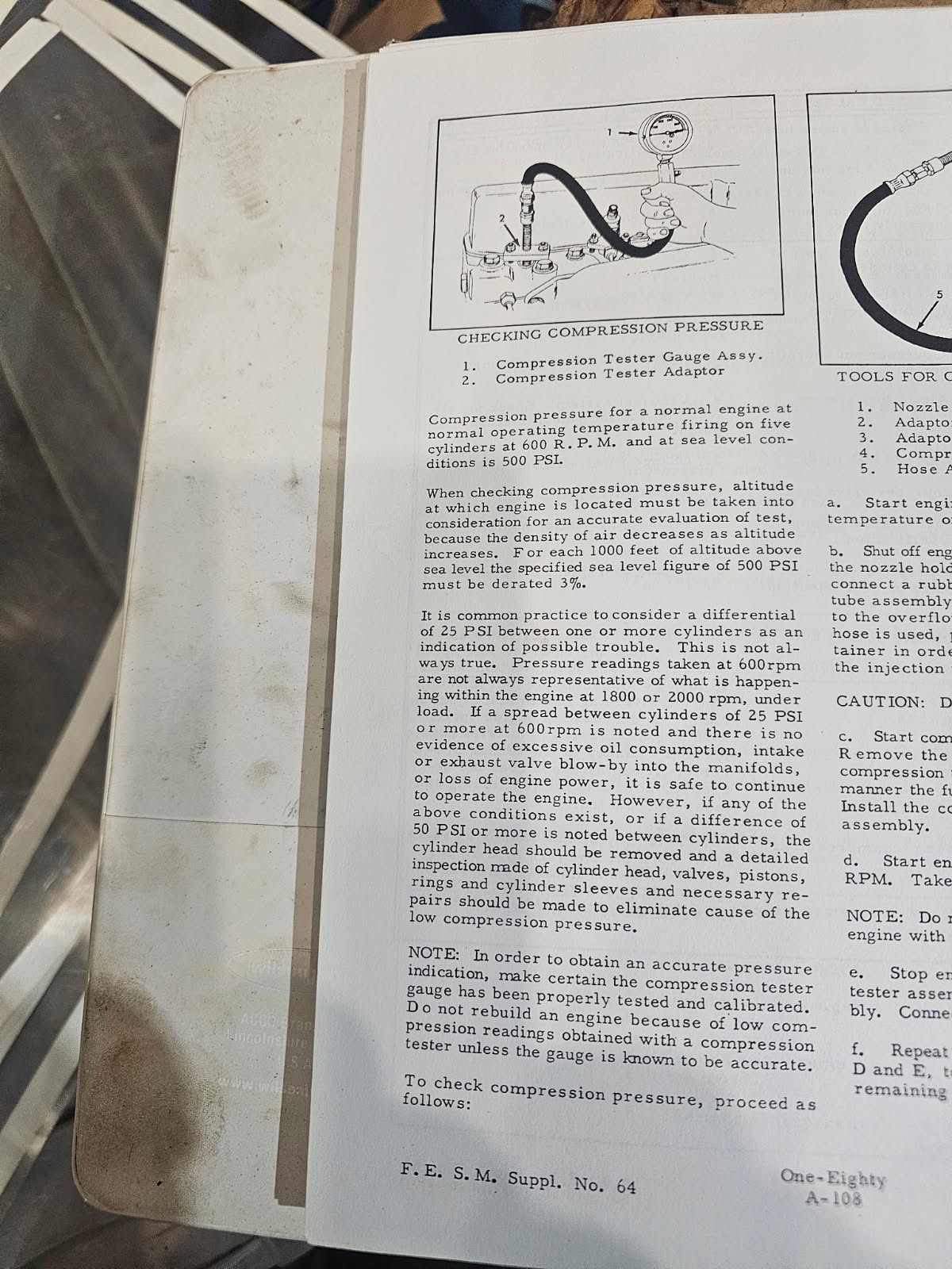

·         I measured compression after letting the tractor get up to a running temperature of 140F.  I then pulled #6 injector, installed compression tester and then restarted it running at idle (750-800 rpm).  This yielded a compression of 350 psi.
o   This above test matches what I found in a 185 Service Manual…it states under similar circumstances, a healthy psi is 500.  My 7020 Service Manual offers no criteria for a compression test.   I noted from the parts book that the piston from a 185 to a 7020 is a different part number so I don’t know if I can use the 185 spec.
·         When running, the engine has near zero blow by out of the valve cover.   This makes me believe the engine isn’t shot.  Also, I can run it down the road in high gear and it seems to have plenty of power.  I wish I had access to a dyno to measure actual horsepower.
What are people’s thoughts on what my issue is?   Has anyone ran a compression test on a healthy 649/301 turbocharged engine?

So, how did it start cold when in a 50 degree F shop before you had injectors and injection pump gone thru ????              Set your pump timing at 16 degrees BTDC and leave it there.     Cranking compression with a known good compression tester should be over 300 PSI with all injectors removed. Running on one cylinder at 700 RPM should yield you 400 psi or a little better.  So, you either have a real problem or you have a compression tester that isn't giving you correct numbers.       What brand starter does it have?? A LUCAS ?? they are known for slow cranking speed, regardless of what you think of the cranking speed. I assume this engine has the DM-4 style injection pump?? and that would have 15 to 1 compression pistons. LEAVE THROTTLE AT A DEAD IDLE TO START.

200 psi is not enough to start a cold diesel engine. I always do compression tests with starter, not per Ac procedure of it running on the other 5 cylinders. You problem starting is at cranking speed, so that is the speed you need to check it as you did, and it proved to be a problem. Faster cranking speed will definitely raise the cranking compression pressure. I don't feel you have an engine problem as much as you have a slow cranking problem. Looks like a great application for an ether start and a gear reduction starter lol!
