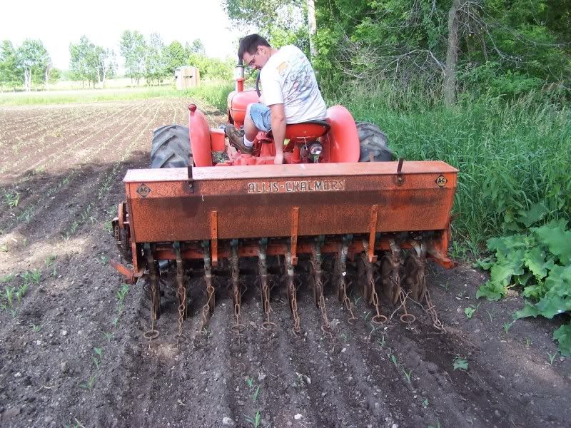

Tom, the spring coils control about 6-8" of vertical movement on each disc and seed tube across the width of the drill. I would think it's no issue. We have used the same drill on both WD and D14 without any issues on hold positions. I think the vertical travel helps make up any differential with the hold pos. Of the tractor. If that makes sense...

The one I had actually hung off the rock shaft.  Just have to adjust the chains to allow the drill to be at the right depth.  Do not need to hold with the hydraulics.

I just planted 13 acres of oats with one of those drills. The rockshaft chains hold it in place and there is an adjustment to help hold pressure on the openers. The fertilizer adjustment is pretty crude and the seed adjustment requires flipping a bunch of gears around. The biggest problem is the capacity is crazy small. Six bushels for grain and 400 pounds of fertilizer.
I like old obsolete allis equipment as much as anyone but this may be a machine best left in the back of the shed. Or maybe i am just exhausted from lugging bags of seeds in the 85 degree heat. My grandfather was a lot more tough than i.
