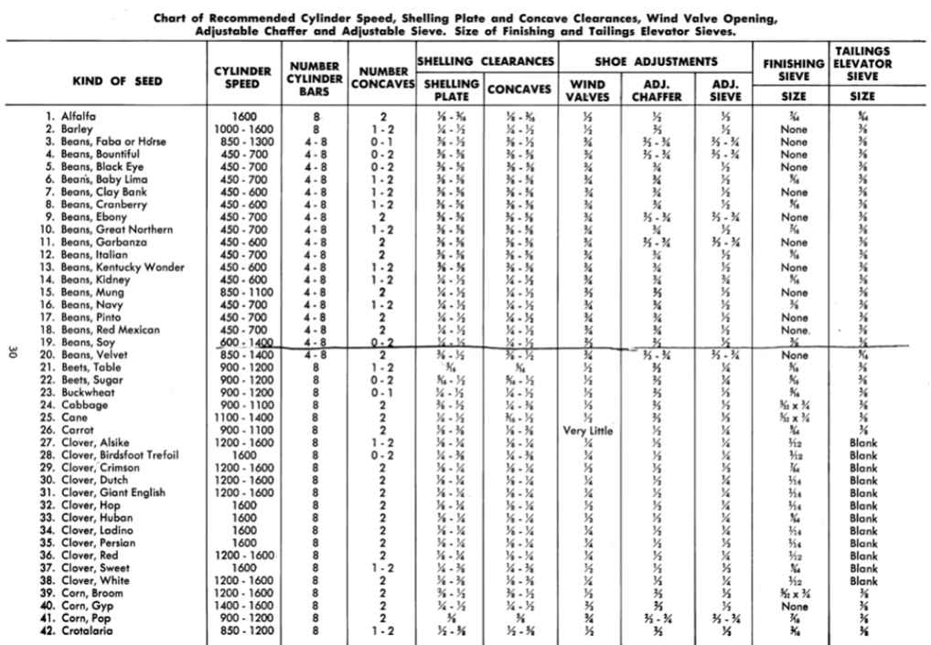

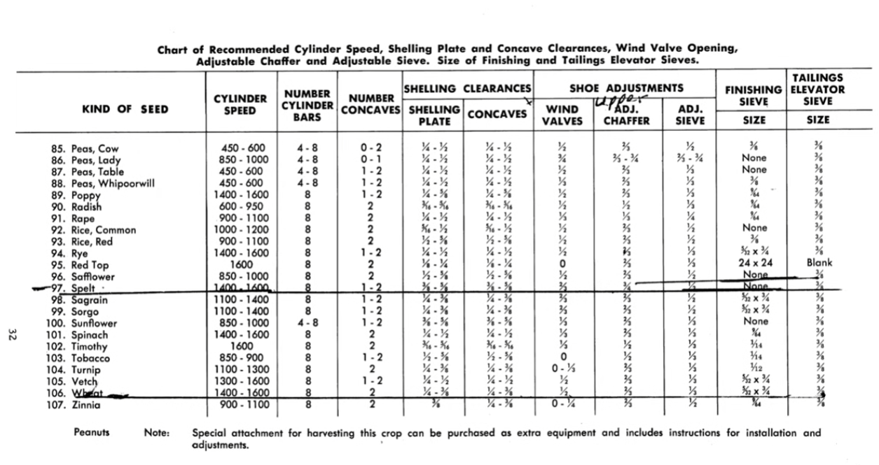

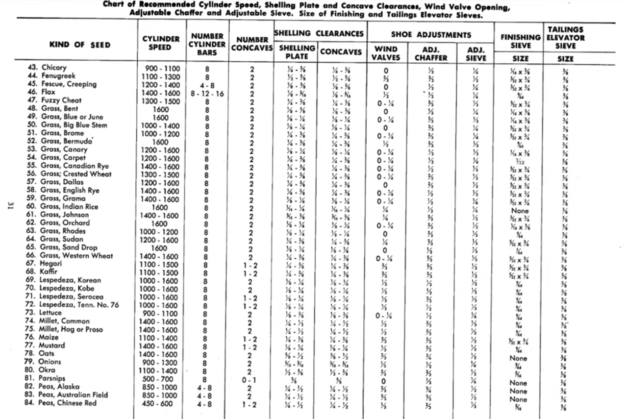

Here are the settings tables for the AC all crop. I pulled these from a video on youtube.
