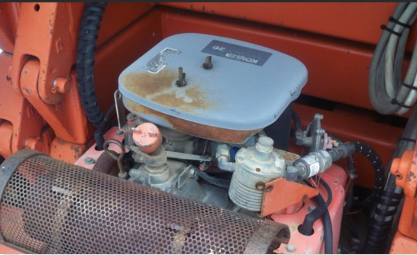

My Snorkel lift has a M20 Kohler engine with a dual fuel system.  I do not have a manual and can not find one on the internet.
It does not want to start when it is 90F or higher.  To get it running, I take off the air cleaner and give it some either.   Tanks are full.  Valves are open.
In doing some reading, it states there is a filter that needs to be changed.
I have attached an image below of the unit.   Does anyone know where the propane filter might be (in the beehive unit-regulator)?   What brand of is this?   Do I take off the top cover of this (with freezer gloves on) to get to this filter?
Please let me know your thoughts...thanks.

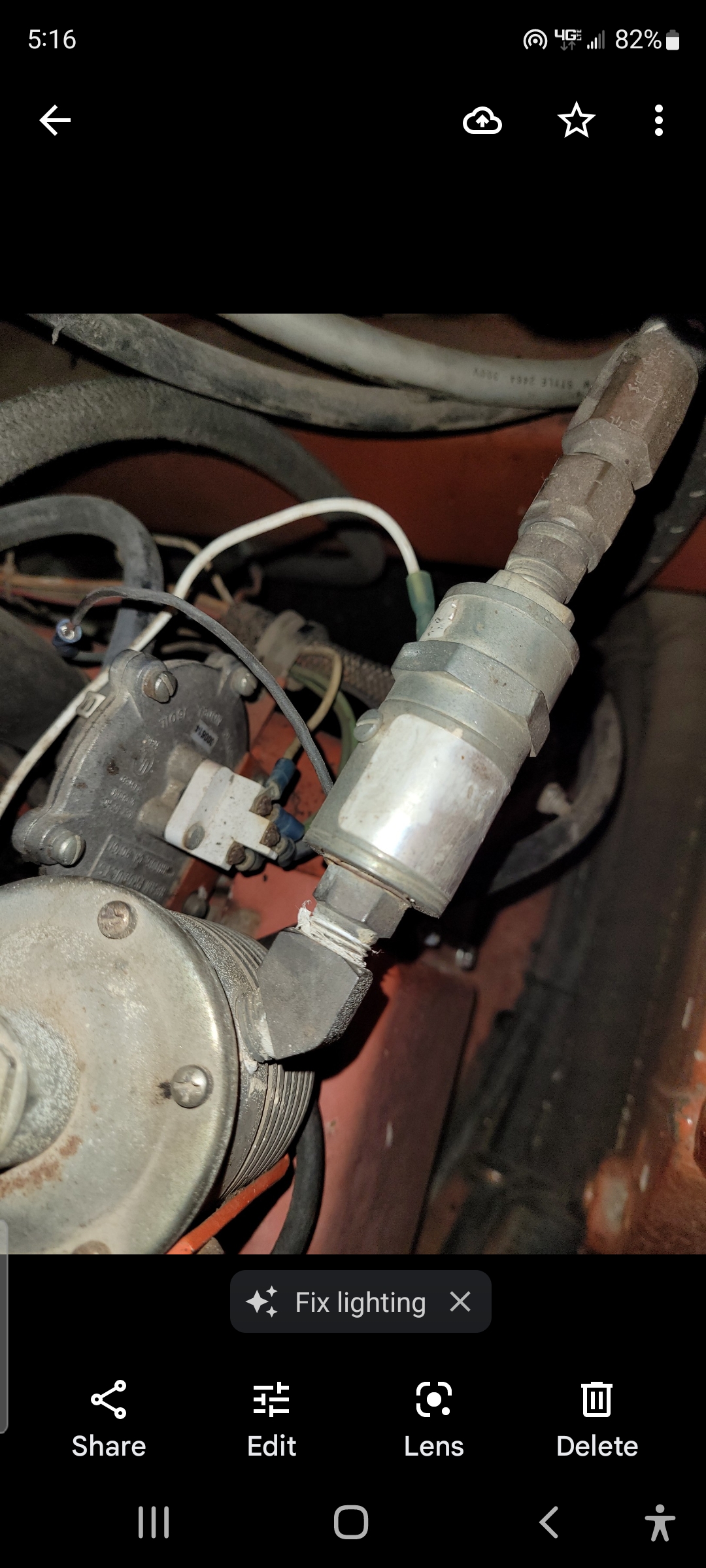

It is a Snorkel 5000 scissors lift.
Here is a pic of the regulator vaporizer. There is no button on the diaphragm part.
Here is a listing of what I think some of my parts look like: https://www.ebay.com/itm/181144072964?mkcid=16&mkevt=1&mkrid=711-127632-2357-0&ssspo=RxTioHAgSLC&sssrc=2349624&ssuid=6AE2ijspRsi&var=&widget_ver=artemis&media=COPY

Post Options Post Options   Thanks (0) Thanks(0)   Quote DaveKamp Quote  Post ReplyReply Direct Link To This Post Posted: 27 Jun 2022 at 12:18am
His photos show one of the early air-heated BEAM regulator/evaporator/filter units and a 1601L fuel lockoff, so it's vapor withdrawl.
Beam still makes an air-heated vaporizer/regulator similar to that unit, but that unit was discontinued from production at least two-and-a-half decades ago.
The most sensible option, would be to replace the original BEAM converter/reg system and fuel controller in lieu of an IMPCO VFF30 and COBRA regulator.
