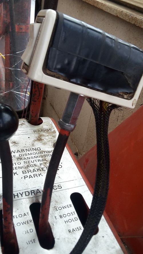

Here is how I run a three function loader (lift, bucket, and grapple fork) with two hydraulic remotes on my XT. The first hydraulic remote just runs the loader up/down function normally. The second hydraulic remote, which as you can see, I have modified the lever, runs both the bucket function and the grapple fork. I run the hoses from the second remote into an electro-hydraulic valve multiplier; one set of hoses in; two sets out. Basically how it works is this. The modified handle (which you may recognize as the top of a hydro handle off of a gleaner combine) has that rocker switch in it that is easily operated by my thumb. If I depress the top of the rocker switch, the bucket is operated when I use that hydraulic lever, and the grapple fork is operated if I depress the bottom of the switch and use the same lever. I know that I did not re-invent the wheel here, and electric button/switches have operated grapple forks for years now. But one thing that I do like about this over new fangled grapple buttons, is that I can still feather the grapple fork with system. The newer ones are either stopped when the button is not pushed, or full blast when the button is activated. So far, I like it. Darrel

Cracked window sure sticks out like a sore thumb in my picture. I best replace that. Darrel

Well I want to know how it is that you posted a photo and I can't believe no one else mentioned it!!!! Now we will expect pics of all you projects!
I have not put up pics since the Photobucket mess and don't care enough to learn a new thing.
My son posted it for me. I have no idea how he did it. darrel
