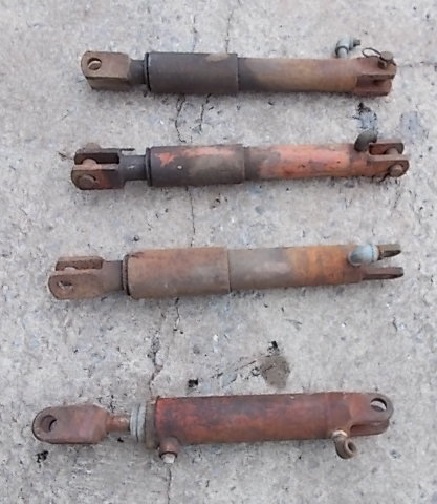

The cylinders on the plow are not the same. I have 2 actualy Allis impliment cylinders and they are different. I'm not sure if you still use the 45 lift cylinder though. Depends if the stroke is long enough and the pins are the right size. I have the 3 bottom version of that plow. It doesn't lift high, so you want all the stroke you can get.

Looking at those pictures the cylinder on the tail wheel does appear to be larger diameter than the lift arm cylinders. I be interested in dimensions of the correct cylinder if someone has one that they can measure. These tools are a bit rough, but better than the ones I didn't have. The plow has an 8 foot tall shrub growing through it if that tells you how long it's been sitting. Nice looking shrub, I kinda would like to take it with me.

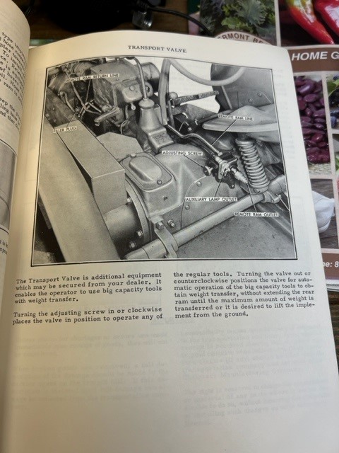

This is a picture of the transport valve and the brief description from my WD45 Diesel operators manual.

 Interesting, if all a guy wanted was a delay a flow control could do that. I suspect that this valve is internally piloted and pressure sensing. The valve could be set to shift based on certain pressures that it sees on the supply line. I'm sure others know exactly how it functions.

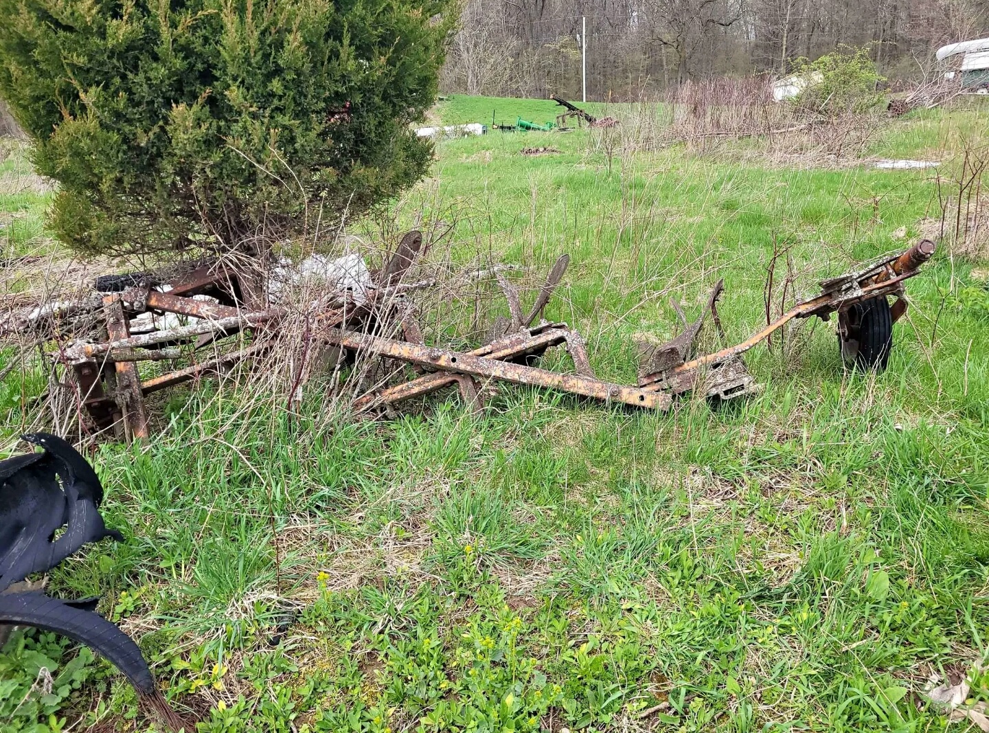

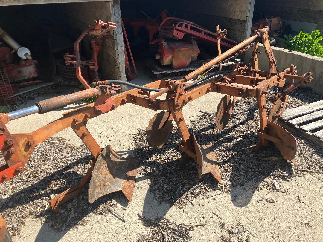

Attached is a picture of the actual plow. Not a great photo but it's all I have.

  Allis Dave,  I have a 60 series semi mounted plow and it has plenty of ground clearance when raised.

I'd say a 64, but it does have the square frame above the regular frame...  It is also missing the gauge wheel that goes in the slot forward of the tail wheel.  Post a picture side view from the coulter side, and it will help the ID process...Wink

That looks to be an 80 series plow frame, as I can see the spring trips for the beams.
  The remote hydraulic cylinders that Allis Chalmers used was not exactly an ASAE standard 8" stroke cylinder, although very close. If you plane on using it behind a WD45 you should have a Hi-Pressure Allis Chalmers cylinder, as lower pressure generic cylinders will not tolerate the pressure that a WD45 hydraulic system operates.
The 2 cylinders I have left are different bore diameters

 I just looked through some E$ay listings for manuals. I believe that it's a 74. It has the same square tube on top of the frame with what appears to be the holes for adjustment that Doc spoke a bit about. Also, the 64 manual didn't show a gauge wheel. That's what I think anyway. It will probably be a week give or take before I actually get it home to get a better look at it.

From the photo, it appears to have the gauge wheel bracket but not the gauge wheel.
My dad had to add a gauge wheel to our model 74 plow. It did not have a gauge wheel on it when he purchased it new.
DO NOT over grease the tail wheel pivot.  One pump to the fittings are all  that are necessary.  Over greasing will cause the tail wheel  to dance in the furrow.
Make sure you polish ALL the rust off the moldboards.  The plow must scour or the power requirements and fuel burn will be horrendous.

I think Paul is correct with 84. Best I can tell they are trip bottoms.    Tracy

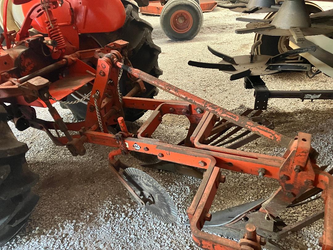

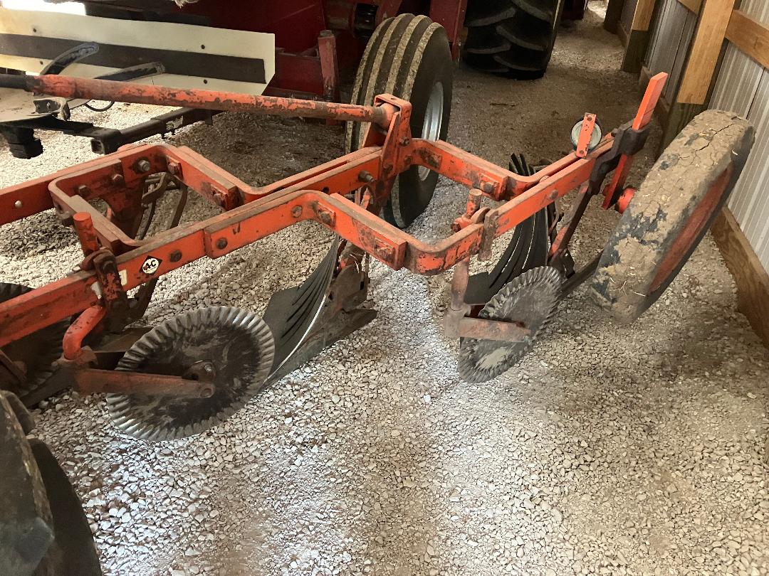

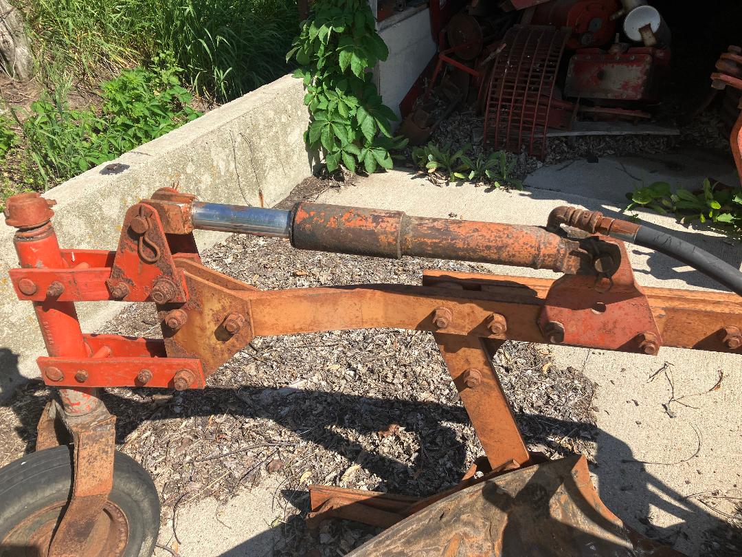

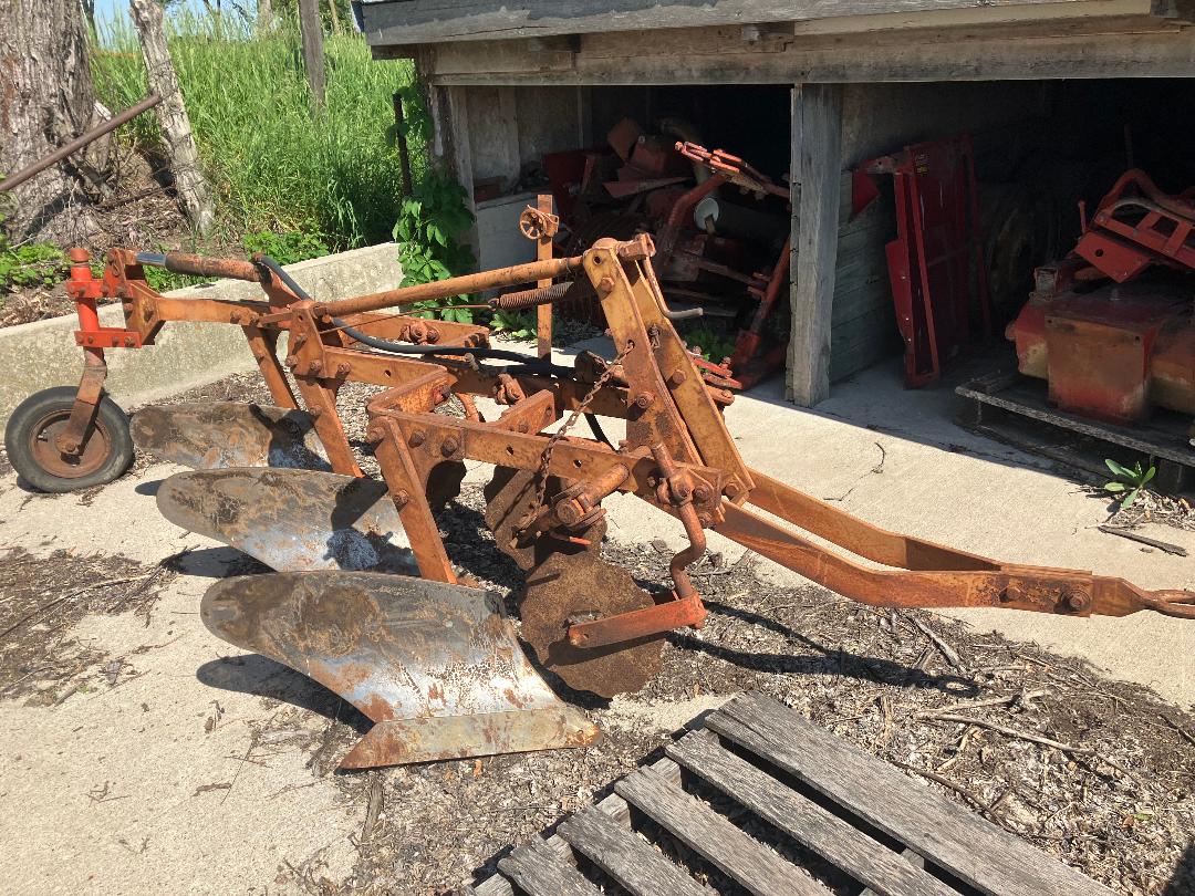

Got a few pictures yesterday, maybe get a few more today. Couple of the 73 to show the adjustable frame and a couple of the semi-mount and one of the lift cylinder.
