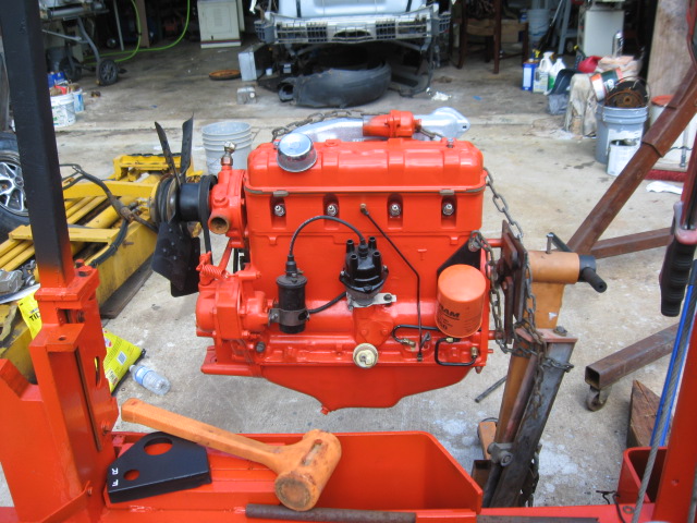

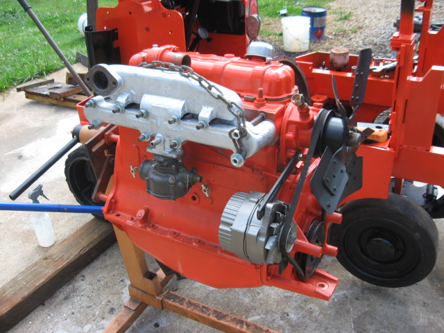

I have a AC acc45 ps forklift that i am trying to get back running after a complete engine, transmission and hydraulics overhaul. I supposedly has a continetal g153 engine. I cannot find any engine overhaul manual. I have hunt and picked all the other systems. Having trouble timing the engine to start it. Trying to verify camshaft timing, static timing and dynamics timing. Also distributor cylinder one position.Confused
Engine casting is AC 4516683

Unfortunately, mine is not a continetal engine. Already have that manual. It is a flat top L-head engine. Mine is more like the buda engine. It has overhead valves.
here are some pics
