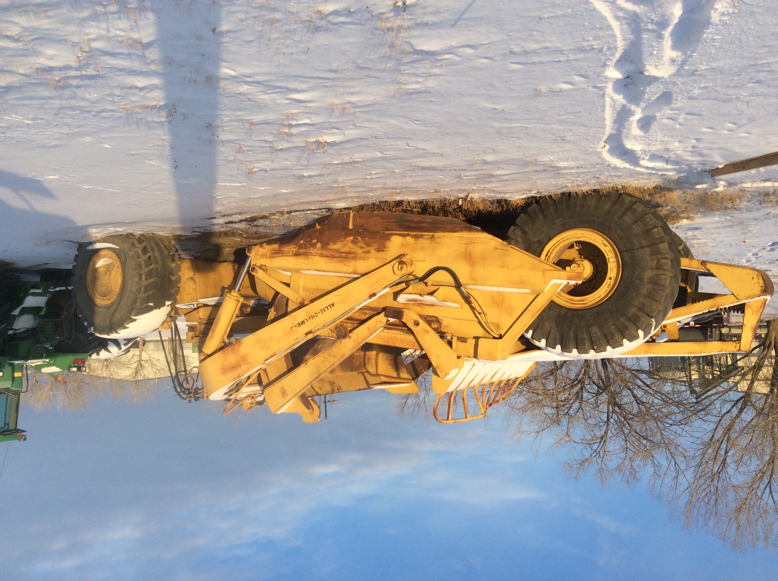

Would some one know the hydraulic working pressure on the push out cylinder on TS 260 . We've converted the unit to a pull unit & needing to know the push out force so we can down size the cylinder to higher pressure.

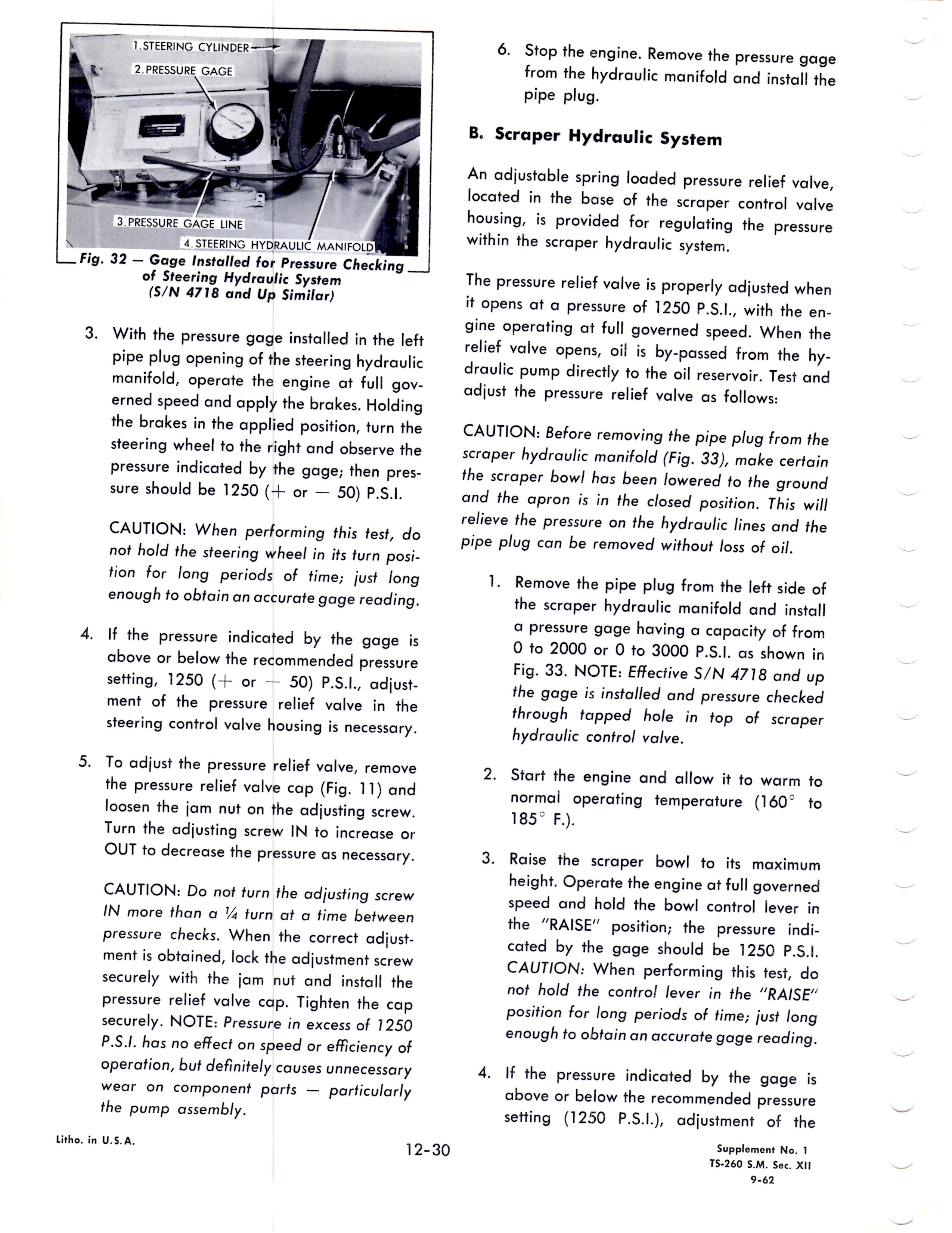

The book I have says 1250 psi on the scraper hydraulics.  Here's a scan of the page.  I'd love to see pics too if you've got em!

Sounds like a pressure relief valve and a flow control might be the way to go rather than downsizing the cylinders

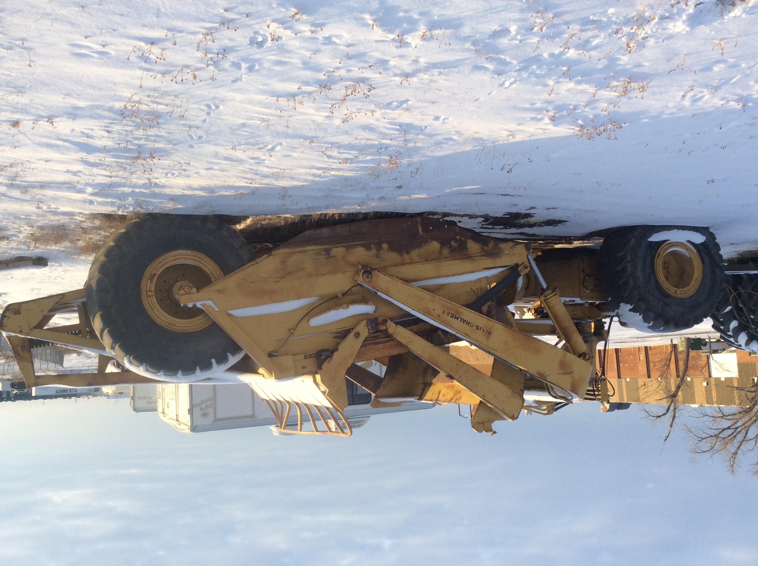

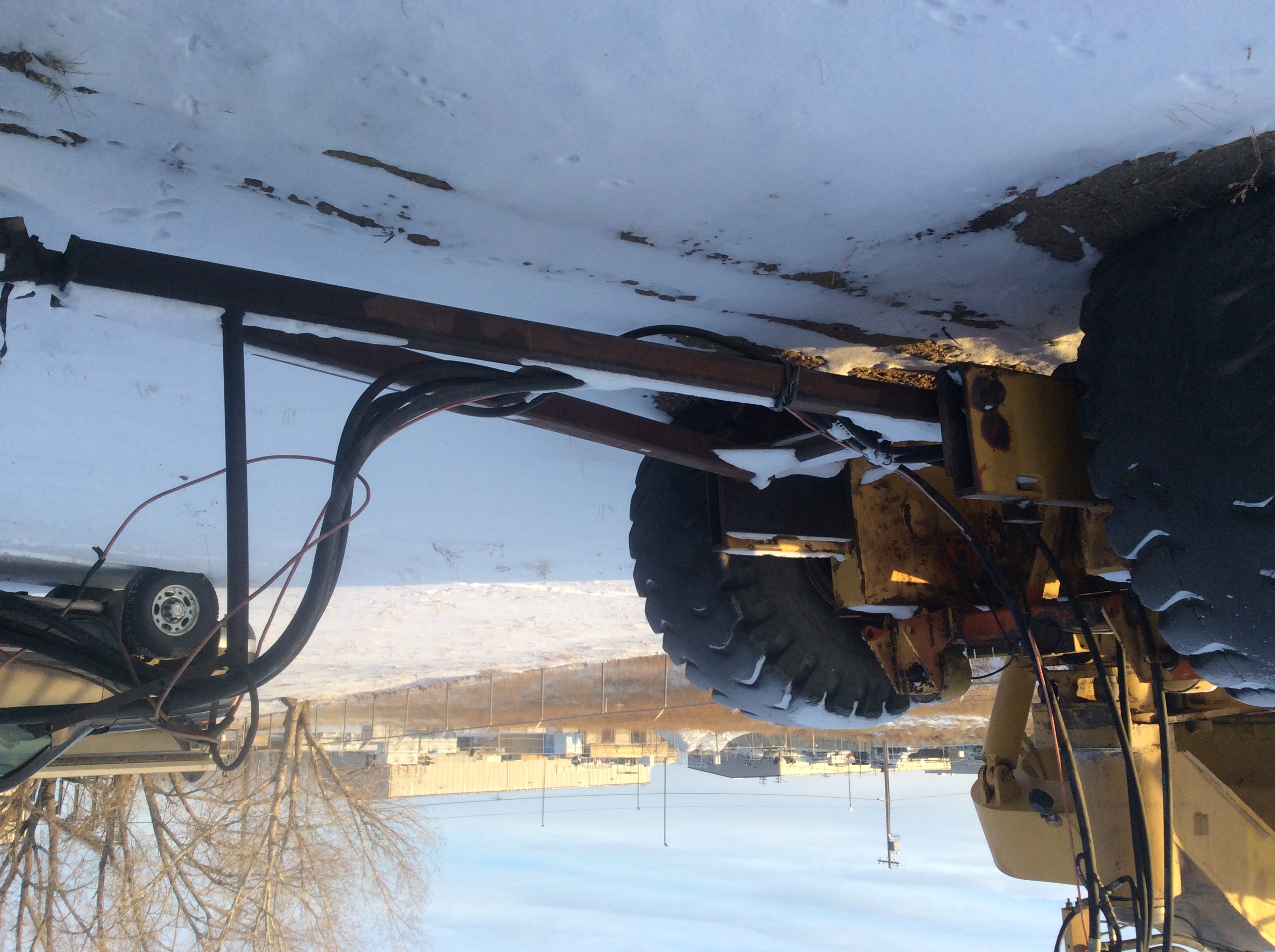

    Thanks James. The reason we need to go to smaller cylinders is because the one way cylinders use so much fluid that some of the tractors do not have large enough Hyd reserve. It's also to slow on the return cycle.

    sorry only half the picture came through I'll try again.

     when posting pics on here, make sure they are right side up or else it will make others wonder how you can keep the dirt in that scrapper when its upside down.... LOL
     Maybe its just my computer but they did appear that way unless I clicked on the image to view.  These two are in my storage now, and someday when I am deleting to make room, they will be removed.
