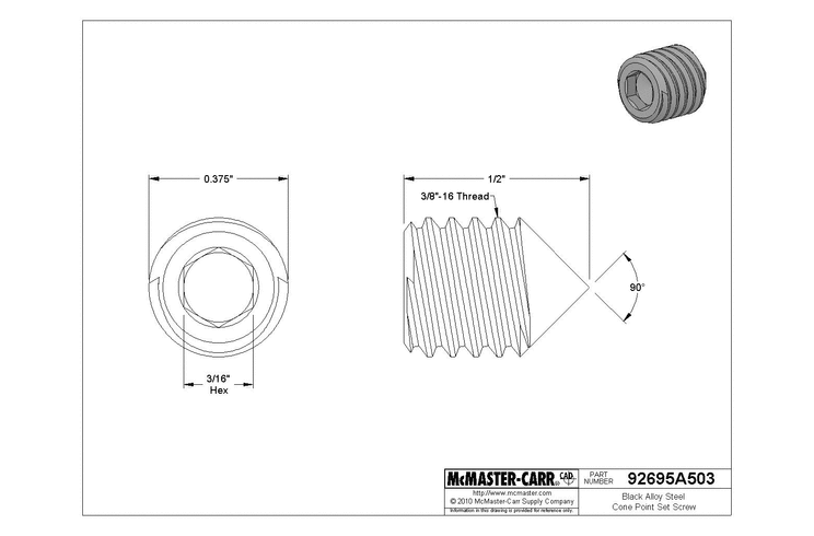

Like this one? From McMaster-Carr?
Gerald J.
Post Options Post Options   Thanks (0) Thanks(0)   Quote CTuckerNWIL Quote  Post ReplyReply Direct Link To This Post Posted: 29 Jul 2010 at 9:30pm
90 degrees? That would be too easy Gerald. LOL

 Gerald; you're kidding,right?Keyword...TAPER.It's 5/8 11 NC with 5/16 Allen head x 1 1/2 long.Mccarr has nothing close.
