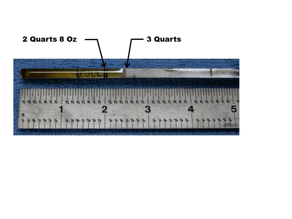

Hi, I have an AC model G with a continental N62 AG01 engine. The dipstick appears to be correct, but when I change oil, it only takes a little over 2 quarts before the level on the dipstick shows it to be at the top of the "full" mark. There are no large dents on the oil pan to cause it to read high. I looked at other dipsticks offered on E-Bay, Etc. and a visual comparison shows the marks to be in the same location.
  This has been driving me buggy for a couple of years because if I try to add 3 1/2 quarts after an oil and filter change I am sure the engine will be over filled. I'v been keeping the level just over the "full" mark and all seems OK.
  Any ideas?

I know what the stated engine capacities are: 3Q or 3.5 Q with filter change. I've included a picture to illustrate my dipstick indication question. The engine is leveled on stands.
Thanks for your responses,
Phil

If the oil pan is OK and it's not got a bunch of gunk in the bottom, then I'd look at the top stop on the dipstick, if it moves up and down on the dip stick shaft you have found the trouble.

The top stop is still welded solid in its original location. Its location also compares favorably with photos of other new and used sticks. The oil pan is clean as a whistle.
  I'm thinking the tube that holds the dipstick is possibly shorter than it is supposed to be for that length dipstick.
Phil

Is the seal just below the top stop still on the dipstick? If it's gone that might be the problem. The best thing to do is get someone with a G tractor to put a tape on the pan, dipstick and dipstick tube and then check the numbers of yours and theirs.
