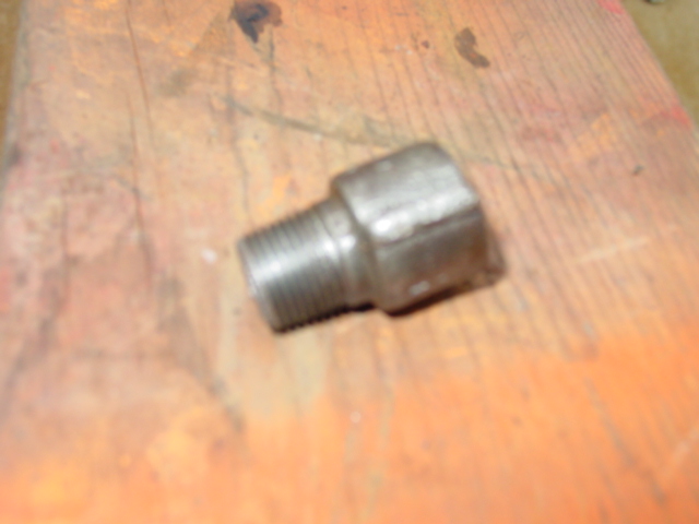

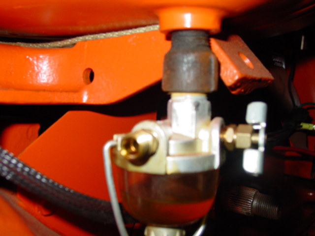

Post Options Post Options   Thanks (0) Thanks(0)   Quote Dick L Quote  Post ReplyReply Direct Link To This Post Posted: 13 Mar 2020 at 6:10am
This fitting goes in the tank first that the sediment bowel then screws into.

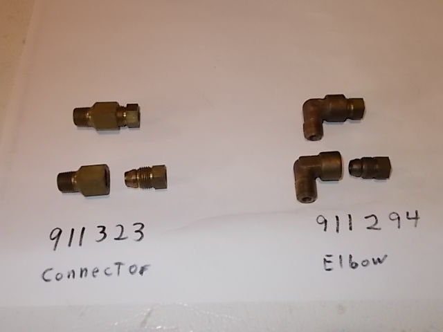

Points: 5140
Post Options Post Options   Thanks (0) Thanks(0)   Quote PaulB Quote  Post ReplyReply Direct Link To This Post Posted: 13 Mar 2020 at 6:41am
These are the correct OEM fittings.

Post Options Post Options   Thanks (0) Thanks(0)   Quote ac fleet Quote  Post ReplyReply Direct Link To This Post Posted: 13 Mar 2020 at 12:20pm
I never seen a fitting like that before!---All of mine screw directly into the tank! ----interesting ! LOL!!!
