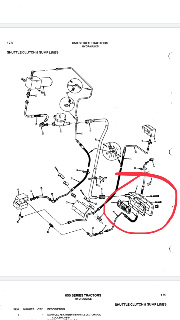

the picture in the parts manual shows where it is.

The way I’m looking at mine it looks like it’s either bolted to the bottom of the rear compartment or inside the compartment.

If you go down the line to the rubber hose. The hose goes on the cover asy.
The cover is held on with 8- 5/6 bolts.                                          the screen is inside.
