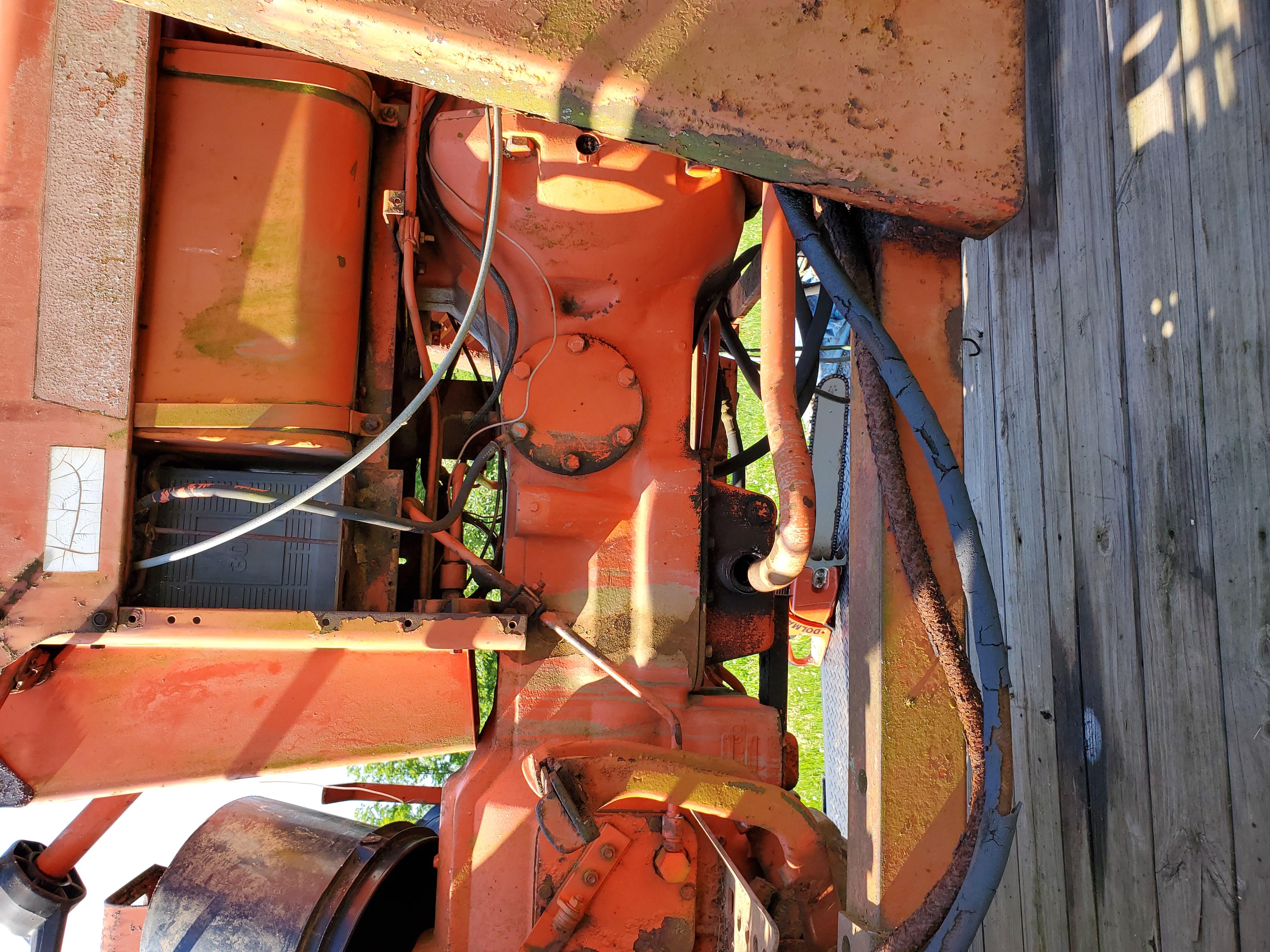

Does the power steering use the same sump as the rest of the hydraulics?  I assume yes? If so, I assume the sump is shown here at the bottom with a pipe disconnected?
If I get the hyd sump buttoned up and filled, could I expect to move the front wheels with steering shaft even if tractor off?  Its %100 hydraulic as far as I can tell, unlike my D17

Steering is "hydrostatic" which means 100% hydraulic. I would not expect to be able to turn the wheels on that tractor. Some tractors will steer with engine off and others will not. All depends on how much internal leakage there is.

So I can get it to steer. Per my previous unanswered question, does the steering hydro use the sump per my pic?
My immediate goal is to get it under cover and take the head off and see what I am dealing with.  Got to be able to move it.

If it had been run recently, it likely would be able to steer a little bit with the steering wheel. But, when they've been sitting for years, there's little chance a hydrostatic steering system from and brand will work. There is a "closed loop" system built into it in case of loss of engine/hyds when driving, to maintain control.
I see...Is the whole hydraulic system closed loop or just for the steering?

Only steering.

Actually the steering is open center also. The steering control is more like a metering valve. As long as it has enough oil in the system, the rotor will pump oil to the cylinder to steer.

The whole tractor is an open center system, but when shut off, the hydrostatic steering system becomes a closed loop manual steering system for very limited use. There's a big difference in closed center, and closed loop system lol!
