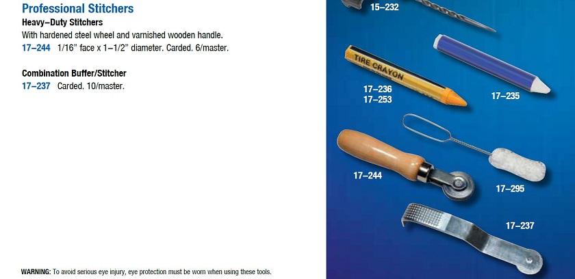

Sounds like you are looking for a "Stitcher". Here are the ones shown in the Tru-Flate catalog a wood handled stitcher, and the buffer/stitcher which sounds like the one you are looking for. A parts store should be able to order one if the don't stock them. Or search Tru-Flate Stitcher on eBay, several of each type came up when I tried that search.

 Hey Jim.ME,,,dang,,you is "King For A Day" on this one,,,,,,,,,Clap That metal one was what I was lookin for but I had No idea it would be called a "stitcher",,,who'ld a thought,,,,LOL No wonder I could not find one on Ebay or Amazon,,, And I also wanted to get one of those cloth applicators for the slick-em I'm gonna get,,,,

The stitcher looks just like the tool you use to put the rubber bead in a window screen.  A good hardware store should have one of those in their screen section.

 Well,,Great comments on this,,, And Jim.ME posted just exactly what I wanted, so I ordered the sticher and cotton applicator,,gonna look into the Ruglide and the Bowes slick em that ole Tom sayin he used it for 52 years,,,being a tire man and usin it that long,,,he outa know,,,!!!Clap
